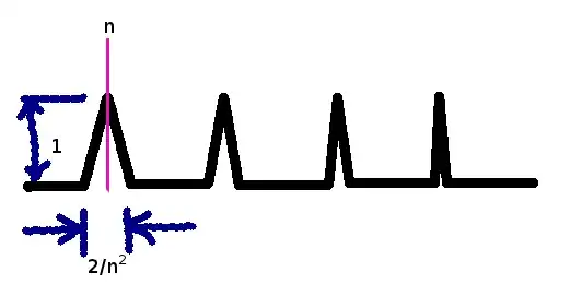

Let me write $p_t(x) = \frac{1}{\sqrt{2\pi t}}e^{-x^2/2t}$ for short. Let $f$ be a continuous function such that for $n \ge 2$, centered around $x=n$, there is a triangular bump of height $1$ and width $2/n^2$. Elsewhere it is 0. Here is a very crude picture.
Notice that the bump centered at $n$ has area $1/n^2$, so $\int_{\mathbb{R}} f(x) dx = \sum_{n=2}^\infty \frac{1}{n^2} < \infty$. Also, since I left out $n=1$, each bump has width less than $1/2$ and so is supported in $[n-\frac{1}{2}, n+\frac{1}{2}]$.
Note $f(n) = 1$ for each $n$. Let's estimate $\int_{\mathbb{R}} f(x) p_t(n-x)dx$. First let's consider the part of the integral outside of $[n-\frac{1}{2}, n+\frac{1}{2}]$, where we have $p_t(n-x) \le p_t(1/2) = \frac{1}{\sqrt{2 \pi t}} e^{-1/8t}$. Thus we can bound this part of the integral by $p_t(1/2) \int_{\mathbb{R}} f(x) dx$. This goes to $0$ as $t \to 0$, so take $t$ small enough that this term is less than, say, $1/4$. (Note this part is independent of $n$.)
Now let's consider the integral over $[n-\frac{1}{2}, n+\frac{1}{2}]$ which contains a single bump. Since $p_t(x)$ attains its maximum at $x=0$, we have $p_t(x) \le p_t(0) = (2 \pi t)^{-1/2}$. Since the bump is actually supported in $[n-\frac{1}{n^2}, n+\frac{1}{n^2}]$ and $f \le 1$, this part of the integral is bounded by $\frac{2}{n^2} p_t(0) = \frac{2}{n^2 \sqrt{2 \pi t}}$. We can take $n$ so large that this is also less than $1/4$.
Thus we have shown that for any sufficiently small $t$, there exists $n$ such that $\int_{\mathbb{R}} f(x) p_t(x-n)dx \le 1/2$ whereas $f(n) = 1$. So we do not have uniform convergence.
