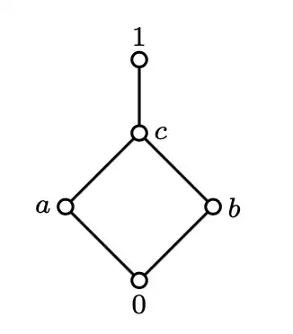

That's not right. Maybe you're overlooking some underlying hypothesis.
To see that that's not true (the second condition), consider the lattice $\mathbf L$ in the picture below.
We will define a Galois connection $\varphi : \mathbf L \to \mathbf L$.
(In this case, it's the same map in both ways, having also the same poset in both sides.)
Notice that in order to show that $$x \leq \varphi(y) \quad\text{iff}\quad y \leq \varphi(x),$$ it is enough to see that $x \leq y$ implies that $\varphi(y) \leq \varphi(x)$ and that $x \leq \varphi(\varphi(x))$, for all $x,y \in L$ (this is a well known alternative definition—or characterization—of Galois connections).
These conditions are immediate if we define $$\varphi(0)=1,\; \varphi(a) = b,\; \varphi(b) = a,\;\varphi(c) = \varphi(1) = 0.$$ However, $$\varphi(a) \vee \varphi(b) = b \vee a = c < 1 = \varphi(0) = \varphi(a \wedge b).$$
