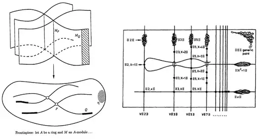

There is a strong conceptual reason to study the prime ideals of a ring: in algebraic geometry, we can study / think about a ring $R$ using an associated geometric object called $\mathrm{Spec}(R)$, the points of which are precisely the prime ideals of $R$. This idea is one of the many Grothendieck introduced, ushering in "modern" algebraic geometry.
(on the left: the frontispiece of Reid's Undergraduate Commutative Algebra)
(on the right: Mumford's famous sketch of $\mathrm{Spec}(\mathbb{Z}[x])$; note that $\mathbb{Z}[x]$ is not Dedekind.)
