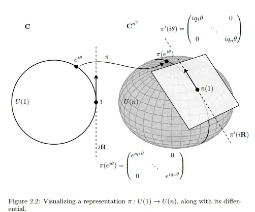

This is one of those ideas that it seems intuitively clear at first, but then it starts to blur out. I see the comment "There is no such thing as the $n$-dimensional representation of $U(1)$." in this post and the explanation in Peter Woit's Quantum Theory, Groups and Representations: An Introduction
Figure 2.2: Visualizing a representation $π : U(1) → U(n),$ along with its differential. The spherical figure in the right-hand side of the picture is supposed to indicate the space $U(n) ⊂ GL(n, C)$ ($GL(n, C)$ is the $n \times n$ complex matrices, $C^{n^2},$ minus the locus of matrices with zero determinant, which are those that can’t be inverted). It has a distinguished point, the identity. The representation $π$ takes the circle $U(1)$ to a circle inside $U(n).$ Its derivative $π'$ is a linear map taking the tangent space $iR$ to the circle at the identity to a line in the tangent space to $U(n)$ at the identity.
I understand how
$$R(U(1)) =\begin{bmatrix}\cos\theta & -\sin\theta \\ \sin\theta & \cos\theta \end{bmatrix} \in GL(2,\mathbb C)$$
which can be expressed as
$$R(U(1)) =\begin{bmatrix}e^{i\theta} & 0 \\ 0 & e^{-i\theta} \end{bmatrix}$$
in the basis of eigenvectors $\left\{ \begin{bmatrix}i \\ 1 \end{bmatrix} , \begin{bmatrix}-i \\ 1 \end{bmatrix}\right\}$
But what is the meaning of representations in $GL(n,\mathbb C)$ with $n>2$? Is the idea to introduce tensorial basis vectors like $e_1 \otimes e_2$? I don't think so, since the block matrix is a direct sum, while tensor products build irreducible representations. What is, in the end, the sphere in the diagram pasted above try to symbolize beyond a single circle embedded on its surface?
Or, alternatively, what is the meaning of each entry (beyond $n=2$) in $e^{-im_n\theta}$:
$$R(U(1)) =\begin{bmatrix}e^{im_1\theta} & 0 & 0 & 0 \\ 0 & e^{im_2\theta} & 0 & 0 \\0&0&\ddots &0\\ 0 & 0 & 0 & e^{im_n\theta} \end{bmatrix}$$
Can I get an example of such a representation with $n>2$ to understand the concept?

Part III: what about the picture? (edited in later)
Your first comment gets it better than the second. The sphere in the picture is supposed to denote the group $U(n)$ of $n \times n$ matrices into which the map $R$ maps. It is a metaphor/analogy/etc: there is no $n$ for which this thing looks like a sphere. However the sphere in the picture is much smaller and thinner (of lower dimension) than the $3$-dimensional space surrounding it, which in 'reality' correspond to $U(n)$ being some geometric object floating around in the $2n^2$-dimensional space of all complex $n$-by-$n$ matrices while being itself much smaller and of lower dimension.
For instance: the space of all $2$-by-$2$ matrices has $4$ complex dimensions, but (hence) from a geometric perspective $8$ real dimensions. The group $U(2)$ sitting inside has only $4$ real dimensions: as a Lie group it is isomorphic to the group of non-zero quaternions under multiplication, so it looks like a real $4$D space with one point removed. Not exactly sphere-like, but it fits the analogy of the picture in that it is a somewhat weird shape of lower dimension floating around in a very straightforward space of higher dimension.
Now when you think of Lie groups as geometric objects sitting in the bigger space of all $n$-by-$n$ matrices, then the image of a map $R$ from $U(1)$ to such a Lie group is just a circle sitting somewhere inside that geometric object. Different representations of $U(1)$ on the same space (hence different maps $R$ into the same matrix group) would correspond to different circles on this geometric object (depicted as a sphere in the picture but not a sphere in reality).
To get an example of such a circle one should not take the example of all periodic functions: the space of such functions is infinite-dimensional, so the space of all 'matrices' (linear transformations) on that space is also infinite dimensional and then we have the group of unitary ones sitting inside there as some also infinite dimensional 'smaller' object - it is really hard to picture.
Instead take maps $R$ from $U(1) \cong SO(2)$ into $SO(3)$. The latter group is a $3$-dimensional object of somewhat hard to picture shape (a real projective space of dimension $3$) sitting nicely inside the $9$-dimensional space of all real $3$-by-$3$ matrices. Now every element of $SO(3)$, viewed as some transformation of $\mathbb{R}^3$, is a rotation around some axis. Conversely: if we fix an axis, we can look at the set of all rotations around that axis and it is not hard to see that it is isomorphic to the circle group. So any isomorphsim $R$ from the circle group $U(1)$ to this set of rotations can be viewed as representation of $U(1)$ on real three-dimensional space.
Geometrically speaking, different choices of axis correspond to different circles in the 3D-blob $SO(3)$ sitting in $9$-space. All these circles pass through the same point: the identity matrix.
Different or not?
Now these different representations, depicted by different circles, are actually equivalent ('the same') when viewed as representations. Somewhat informally speaking this is what you get if their corresponding circles in the geometric object $SO(3)$ can be shifted onto one another without tearing or stretching.
Now how about an example of non-equivalent (actually different) representations on the same space? Here we return to the one-dimensional irreducible representations of $U(1)$.
One-dimensional representations of $U(1)$ revisited
Each such $R$ is a map from the Lie group $G = U(1)$ to the matrix group $U(1) \subset GL(1, \mathbb{C})$. The latter is the analogue of the sphere in the picture: it is a one-dimensional sphere (circle) sitting inside the bigger $2$-dimensional space (complex plane) of all 1-by-1 matrices.
Now each representation draws a circle on this circle. How can they be different? This is where the 'different speeds' from your comment come in.
The representation that sends $e^{i\theta}$ to $e^{i\theta}$ is just the ordinary way of mapping a circle to itself. The representation that maps $e^{i\theta}$ to $e^{2i\theta}$ wraps the circle twice around the target circle. The representation that maps $e^{i\theta}$ to $e^{-i\theta}$ wraps the circle once around the target circle, but in the opposite direction. Etc.
You can see how they are inequivalent: if you wrap a rubber band twice around a cylinder you have no way to get back to the situation where it is wrapped around only once.
So what about the decomposition?
What is missing in this picture is how to see the decomposition of a (say) two-dimensional representation into two one-dimensional irreducible ones. For this I recommend to think about $U(2)$ not as a sphere but as a torus. Equally inaccurate, but much more helpful.
A $2$D-representation of $U(1)$ then corresponds with a circle drawn on this torus, that perhaps winds around and trough the hole in some complicated way. The nice decomposition then corresponds to saying: "Wait, if I only look in the 'through the hole'-direction it just makes one simple circle and if I look in the 'around the hole' direction it makes two circles before returning home, so this 'complicated' representation is just the direct sum of the one that sends $e^{i\theta}$ to $e^{i\theta}$ and the one that sends $e^{i\theta}$ to $e^{2i\theta}$!"
In the geometric picture, the subrepresentations correspond to different 'directions' and the decomposition corresponds to understanding the circle by projecting down to those directions.
