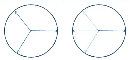

Consider the cube roots of unity. You can write them in the plane with $x$ being the real part and $y$ being the imaginary part. They give three vectors all with unit length, equally spaced around the unit circle. Now let's add the two vectors that are not 1 (ie, the two that face to the left) and you get $-1$ as shown in the second picture below (the light vectors are gone and their sum is the left-pointing vector which represents $-1$). Of course you can add any two vectors you like, but it will always give you a vector that is the negative of the remaining one. Adding the final two will give 0. This happens for any number of vectors when they are a complete set of all roots of unity.
Cube roots of unity
Note: This is far from a rigorous proof, but I'm trying to appeal to your intuition. The picture isn't nearly so nice for 5-ths roots of unity.

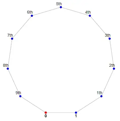

There's another intuitive explanation I haven't seen mentioned yet. If you start at the origin and draw a regular $n$-gon with side length 1, starting by going from $(0,0)$ to $(1,0)$ and then proceeding counterclockwise, then the vector corresponding to the $k$th side is exactly $\zeta^{k-1}$. But since the $n$-gon ends out back at the origin, the sum of all these vectors is exactly $0$. Thus the sum of all $n$th roots of unity must be zero.
Zarrax
  • 46,591
