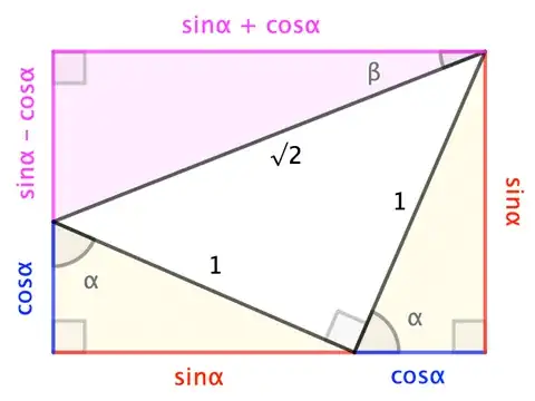

Here's a diagrammatic verification for acute $\alpha$ and $\beta$:
