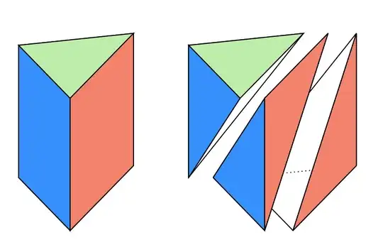

For the base case, you can decompose a prism like so. To see that the three pyramids have the same volume, note that the left and middle pyramids share a blue base and have the same height; similarly, the middle and right pyramids share a red base and have the same height.

  • Thanks so much for your answer, it's beautiful in its simplicity! I'm not quite sure how you'd split a triangular prism into pyramids; would you mind elaborating please? – A-Level Student Oct 29 '20 at 18:09
  • @A-levelStudent Glad to help. I drew a picture illustrating the decomposition. – Théophile Oct 29 '20 at 18:33
  • Thanks for the illustration, I really appreciate it. So how exactly does that show that the volume of a triangular pyramid is $\frac{1}{3}Ah$? – A-Level Student Oct 29 '20 at 18:38
  • @A-levelStudent Given that the three pyramids all have the same volume, it follows that they each have a volume equal to a third of that of the prism, which is $Ah$. This is very similar to calculating the area of a triangle: cut a rectangle in a half along the diagonal, and, observing that the two resulting triangles have the same area, they must each be $\frac12wh$. – Théophile Oct 29 '20 at 18:43
