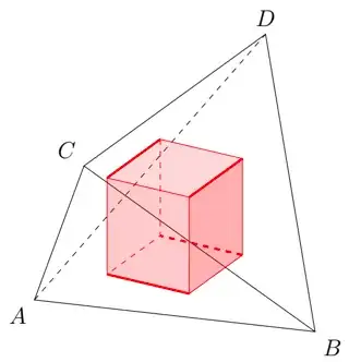

For the $17$ working cases, there are "nice" constructions, where the solids are positioned in symmetric ways with respect to each other. Consequently, such constructions are pretty easy to verify by a combination of symmetry arguments, direct computation of one or two distances, and arguments from degrees of freedom / continuity. To see examples of these pairs, Moritz Firsching's 2018 paper "Computing maximal copies of polytopes contained in a polytope" (PDF link via arXiv.org) shows instances of maximal containment, most of which have "nice" symmetry (or are obviously given by e.g. taking duals). Perhaps the hardest case to see a "nice" construction for is the cube inside the tetrahedron, pictured below (bold edges tangent to the faces):
                                             Tetrahedron in a cube
