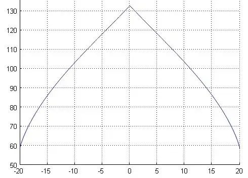

Using DFT, I have obtained the following ogival curve for this Fourier transform (code below); I will continue to work on this question ...
Matlab code:
x=-20:0.011:20;
c=1; % other values give almost the same shape
s=1./abs(x-c);u=fftshift(abs(fft(s)));
s=1./abs(x+c);v=fftshift(abs(fft(s)));
w=conv(u,v,'same');
plot(x,1e-7*w);
Remark: Wolfram Alpha, to the question phrased in this way: FourierTransform[1/Abs[x]], does provide an answer:
$$\tfrac{1}{\sqrt{2 \pi}} \int \tfrac{1}{|x|} e^{i\omega x}dx=-\sqrt{\tfrac{2}{\pi}}\left(\log(|\omega|)+\gamma\right)$$
The normalization factor $\tfrac{1}{\sqrt{2 \pi}}$ isn't an issue, we know it (it is one of the "avatars" of the Fourier Transform); but where have the $2 \pi$ and the dirac $\delta$ gone? ...
