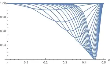

I prefer to do this this analytical process.
Look at the function with lower k:
I mathematica it is often sensible to look at the function sequence on the borders of the interval of interest. In this case it is possible to state this values for all k. $f(0)=1$ and $f(0.5)=0$. Inbetween the function can either be bigger or smaller than $1$. The functions are polynoms in x, so monomials, but with mixed order. So they are steady and differentiable on the interval and the boundary. There positive as well as negative. But both terms are positive on the interval for all k $1>0.5>x>0$.
There must be for each k a global unique minimum or maximum. This property decides whether the function are bigger or smaller than $1$ in the interval $(0,0.5)$.

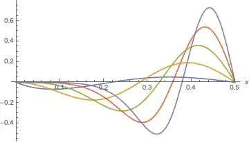

The first derivative looks even as nice as the function:
first derivative
This few derivative show the beauty and complexity of the derivatives in full.
$$(1 - x)^(2^k x^ k) (-((2^k x^k)/(1 - x)) + 2^k k x^(-1 + k) Log[1 - x]) + x^(2^k (1 - x)^k) ((2^k (1 - x)^k)/x - 2^k k (1 - x)^(-1 + k) Log[x])$$
Because this already has the logarithm function combined with the polynomials it is not solvable in a closed form.
With numerical methods it is easy to find the zeros of the functions sequence. It starts with
$${0.216454, 0.281732, 0.326587, 0.357129, 0.378871, 0.395017, \ 0.407435, 0.417264, 0.425226}$$
What we need for a prove is only that there is one for shure for all k.
All these function value at the extrema are smaller than $1$.
$${0.990665, 0.973494, 0.960633, 0.951346, 0.944465, 0.939202, \ 0.935062, 0.931727, 0.928985}$$
This is in the start already a continuously falling sequence. Since these are polynomial this will continue for all k. At that is the prove with the methods of numerics and analysis.

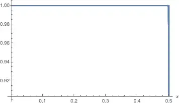

$\lim_{k\rightarrow\infty}(1−)^{(2)^}+^{(2(1−))^}=1$ if $\log(1 - x) < -\log(2)$ $and$ $\log(x) > -\log(2)]$
So the function sequence converges pointwise towards 1, but remains the extrema which is proven as a global unique minimum but the minimun converges to 0.5. The limit therefore is constant $1$.
limiting function approximated k=1000
These can be interpreted as a sum of two sequences. The first one is the same as the second one if 1-x=t and 0.5<t<1. So the first part increases with k to 1 and the second to 0 with k. Like the functions sequence $x^k$ converges to 0 on $(0,1)$ converges this functions sequence to $1$. $x^k$ converges pointwise and global on $(0,1)$. The function sequence (1−)^{(2)^}+^{(2(1−))^} just converges pointwise on $(0,0.5)$. The global minimum on $(0,0.5)$ converges to $0.5$ and $1$ from below.
