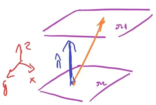

Proof sketch:
  1. Draw the two parallel planes! (let's call the two planes $\pi_1$ and $\pi_2$)
  2. Pick one point on each plane, construct a vector from these two points [ assume coordinates of the point]
  3. Dot this vector with the normal of the plane [ why? look at the picture!]
Legend:
  • orange vector is the one connecting the point on each of the parallel planes
  • Blue is the normal (same for both planes)

  • I have added a picture and written a proof sketch, I suggest you try it yourself. If you don't get it then don't hesitate to ask for hints – Clemens Bartholdy Oct 20 '20 at 17:58
