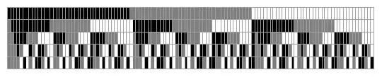

I've translated the constraints into a set of boolean expressions. These were then translated into Conjunctive Normal Form (CNF) and solved using a SAT solver.
The result:
Obviously, A.Schulz' "fiddle around" solution has taken more human intelligence and deeply impressed me. Well done!

Since the order cannot be of matter, we fill the top rows with 13 of each in order giving ($-1 \times 13, 0 \times 13, 1 \times 13$) and we call them block-columns A,B,C. Similarly, if we fill the next row using ($-1 \times 13, 1 \times 13, 0 \times 13$) (block-columms D,E,F), we would have already solved the problem completely if it was asking for a $ (4) \times (3 \times 9) $ matrix, because each block-column can then be filled with the $9$ permutations left for the two remaining rows, while satisfying all conditions automatically because of our choice of roots and permutations balancing the digits equally.
But this is already a good partial result, so we do just that, except that we split D,E,F into (D,D'),(E,E'),(F,F') with D,E,F of size $9$ columns each, and the others of size $13-9=4$ each. We still need to determine how D',E',F' are filled. To avoid negation conflicts, we choose (for the second rows still) ($1 \times 4, 0 \times 4, -1 \times 4$).
We are done if we fill the last two rows of D',E',F'. E' is guaranteed to be conflict free (except for $(0,0,0,0)$) so we use it as a 'rest collector'. For D',F', their roots being negatives, we simply decide to make the rest two columns equal, and this is indeed possible. We need for each row to use four of each digit (to add up to $13$). So we split $-1$ two for each of D' and F', then we take one $0$ for each and one $1$ for each, putting the rest in E'. We are done.
The result then looks like this:
enter image description here (This probably does not generalize easily though.)
