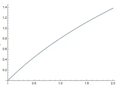

The usual way to calculate fractional iterations of functions is to use Newton's series as described here:
$$f^{[s]}(x)=\sum_{m=0}^{\infty} \binom {s}m \sum_{k=0}^m\binom mk(-1)^{m-k}f^{[k]}(x)$$
For the function $\ln x$ the series diverges, but if you take $\ln(x+1)$ it works fine, for instance, here is the half-iteration of $\ln(x+1)$ using this series:
Mathematica code:
n := 50
it := 0.5
func := Function[x, Log[x + 1]]
iter[k_Integer, x_] := Nest[func, x, k]
Iter[x_, i_] :=
 Sum[Binomial[i, m]*
   Sum[(-1)^(k - m)*Binomial[m, k]*iter[k, x], {k, 0, m}],
     {m, 0, n}]
ReImPlot[{Iter[x, it]}, {x, 0, 2}, AspectRatio -> Automatic]
