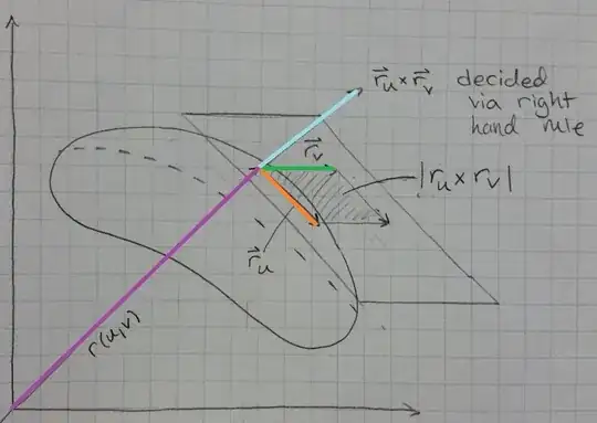

We can form similar rules for each additional example, draw in an arbitrary position vector r(u,v), then draw in to the best of your ability the two tangent vectors, and using the right hand rule match the order of the vectors so as to supply the outward directed normal.

  • As for a non geometric proof you can look at the answer below, but I agree with him in that you do basically need a sense of what the surface is doing to get a sense of direction. As for the second thing I stated, this is the relationship between a surface and its tangent plane. If the vector r(u,v) traces out a surface, then the two derivatives $r_u$ and $r_v$ are naturally tangent to the surface (for basically every function that stewart cares about). Since these two vectors lie tangent to the surface they are in the tangent plane and so their cross product is perpendicular to that plane. – Triatticus May 02 '14 at 03:00

  • I tried my best to make a hand drawn image of what I mean, which is typical of the section in Stewart relating to this material. http://tinypic.com/r/35jifpl/8 – Triatticus May 06 '14 at 02:58
  • +1. Thank you very much. I posted a coloured version of your picture in my OP, but you used $\mathbf{u, v}$ in your picture, and not theta or phi? Also, would you please confirm which colour matches which vector? –  May 07 '14 at 14:09
