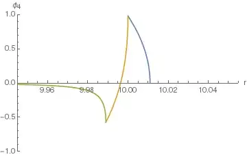

Now, to find the displacement response $\phi_4(r,t)$ of the (4+1)-dimensional equation, we can use $\phi_5$ instead of $G_5$ in $(25)$. We'll get
$$\phi_4(r,t)= \frac1{4c^3\pi^2r^2w^2} \begin{cases} \sqrt{c^2(t+w)^2-r^2} & \text{if }\,ct\le r<c(t+w),\\ \sqrt{c^2(t+w)^2-r^2}-2\sqrt{c^2t^2-r^2} & \text{if }\,c(t-w)<r<ct,\\ \sqrt{c^2(t+w)^2-r^2}-2\sqrt{c^2t^2-r^2}+\sqrt{c^2(t-w)^2-r^2} & \text{if }\,r\le c(t-w),\\ 0 & \text{otherwise.} \end{cases}$$
Here's a sample of $\phi_4(r,t)$ for $c=1,$ $t=10,$ $w=0.011:$
What happens in the limit of $w\to0$? By cases in the above expression:
  1. The first case (blue line in the figure above) corresponds to the leading edge of the force function bump, it's located outside of the light cone of the Green's function $G_4$. As $w\to0$, the area under its curve grows unboundedly, tending to $+\infty$.
  2. The second case (orange) corresponds to the trailing edge of the bump. A zero inside the domain of this case splits the function into a positive and negative parts. The integral of this function times $r^3$ diverges to $-\infty$.
  3. The third case (green) corresponds to the wake after the force function bump ends. It's negative in the whole its domain, and the integral of it times $r^3$ diverges to $-\infty$. The term itself in the limit of $w\to0$ becomes, for $r<ct$, exactly the second term of $(36)$.
Together, however, the integral $\int_0^\infty r^3\phi_4(r,t)\,\mathrm{d}r$ for $t>w$ remains finite, equal to $\frac t{2\pi^2},$ regardless of the value of $w.$
