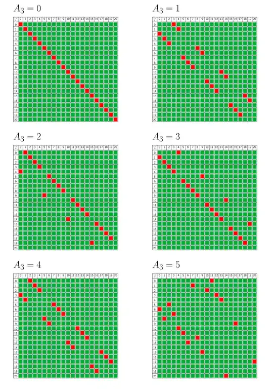

  • I wrote a program that can determine whether the first or the second player will win for a given configuration. The algorithm is basically Minimax with memorization: It considers every possible game state that can be reached from the starting configuration and calculates the winner for each of these states recursively. Because this algorithm has a really bad time complexity, the program can only handle small amounts of coins and steps before the execution time gets too large. The source code can be found here.
    The following image visualizes the output of the program for all initial configuration with $0\leq A_1,A_2\leq20$ and $0\leq A_3\leq5$ ($A_j=0$ for $j\geq4$, $A_0$ is irrelevant). If a cell of the table is green, the first player wins this game configuration. If it's red, the second player wins.
    Visualization of game configurations
    As you can see, there is a clear pattern for $0\leq A_3\leq4$. But for $A_3=5$, I cannot make out any order. It looks quite chaotic to me. If you go higher than $A_3=5$, it's even more chaotic.

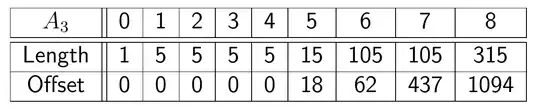

The following table shows the lengths of the repeating pattern and the number of terms before it starts (offset) for different $A_3$:
Table of pattern length and offset
The pattern length and the offset seem to grow as $A_3$ gets larger. You can also notice that the pattern length for $A_3=j$ is an integer multiple of the pattern length for $A_3=j-1$. I can't make out a similar pattern for the offset values.

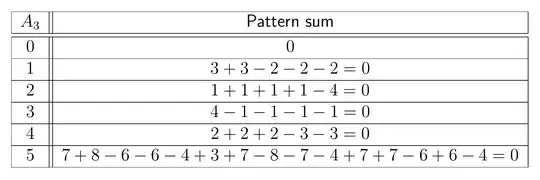

Upon closer inspection, I realized something: If you look at the sum of all numbers within a pattern for some $A_3$, you will get $0$.
Table of pattern sums
I have checked this property for $A_3\leq8$, but I believe that it holds for all $A_3$.
This gives me some hope for finding a formula for the values of a pattern. They may not be that random after all.

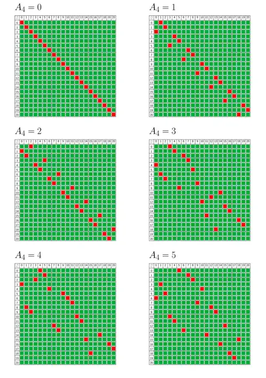

The following image visualizes the losing states of $S_2$ for all initial configurations with $0\leq A_1,A_2\leq20$ and $0\leq A_4\leq5$ ($A_j=0$ for $j\geq5$, $A_0$ and $A_3$ are irrelevant). The losing states are colored red.
Visualization of losing states
You can see a pattern for $0\leq A_4\leq2$, but for $A_4\geq3$ the chaos takes over again. I really hoped for something more regular. I thought that analyzing $S_2$ might help to solve $S_\infty$, but right now it doesn't look like it. Anyway, I will do further analysis of $S_2$ in another update.

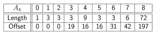

After $19$ terms of chaos, a repeating pattern of length $3$ emerges. This is analogous to the losing sequences we inspected for $S_\infty$. Also, it holds for larger $A_4$. Here is a table showing the length and the offset of the repeating pattern for certain values of $A_4$:
Table for pattern length and offset
As you can see, the length and the offset seem to grow as $A_4$ gets larger, which also is the case for $S_\infty$. The pattern length is again an integer multiple of the previous value, except for $A_4=5$. The offset values look random, except for the value of $16$ repeating once.

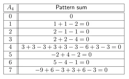

If you add the values of a particular pattern together, you again get $0$:
I think that there is such an infinitely repeating pattern with sum $0$ for any $A_4$, but (of course) I can't prove it.
