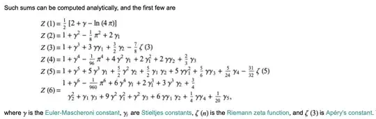

This WolframMathworld-page, mentions:
$$Z(n) = \sum_{k=1}^{\infty} \left( \frac{1}{\rho_k^n} + \frac{1}{(1-\rho_k)^n}\right) \quad n \in \mathbb{N}$$
where $\rho_k$ is the $k$-th non-trivial zero of the Riemann $\zeta$-function.
The page also lists these first 6 finite series expressions for $Z(n)$:
