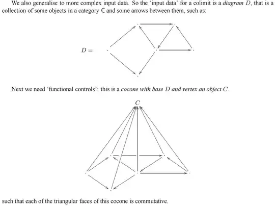

I like the picture of a cocone from https://arxiv.org/abs/math/0306223:
cocone
They describe it through a story about people sending emails to each other.
And then:
A cocone which is universal is a colimit. ―https://ncatlab.org/nlab/show/cocone
Added:
Colimits glue. Limits cut. ―Adam Hughes
    I hate diagrams, they never help and they almost always confuse. But I suppose other people might find this helpful. So thanks! – Asaf Karagila May 22 '15 at 06:16
