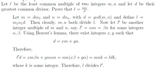

I don't understand why $l'd = xm\beta n + yn\alpha m$ when $l' = \alpha m = \beta n$ and $d = xm +yn$.
Why should it be wrong? It is correct. $l'd=\beta n(xm+yn)=\beta n xm+\beta ny n=xm\beta n+yn\alpha m$. – Dietrich Burde Oct 04 '20 at 11:52
I don't understand. Just multiply both sides of $d=xm+yn$ by $l'$. Use the indicated substitutions. – lulu Oct 04 '20 at 11:53
oh! ok Thanks! but why does "$l$ divides $l'$" imply that $l = nm / d$ ? – jun Oct 04 '20 at 11:55

It appears that your definition of the least common multiple $l$ of $m$ and $n$ is
- $m\mid l$ and $n\mid l$
- for all nonnegative integers $l'$, if $m\mid l'$ and $n\mid l'$, then $l\mid l'$
Assuming $m,n>0$, otherwise $ld=mn$ is obvious, your first step is to define $l=m_1n_1d=mn/d$ (with your notation) and then you prove that $l$ satisfies the two properties above.
The first property is clear, because $l=mn_1=nm_1$.
Now let's prove the second propery. If $m\mid l'$ and $n\mid l'$, we have $l'=\alpha m=\beta n$. So far, so good. By Bézout's identity, $d=xm+yn$ and therefore \begin{align} l'd &=l'(xm+yn)\\ &=l'xm+l'yn\\ &=\beta nxm+\alpha myn\\ &=mn(\beta x+\alpha y)\\ &=d^2m_1n_1(\beta x+\alpha y)\\ &=ld(\beta x+\alpha y) \end{align} Cancelling $d$ we obtain $$ l'=l(\beta x+\alpha y) $$ and therefore $l\mid l'$ as wanted.
