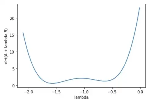

With positive definite symmetric matrices, I did a few experiments in python and here is a counter-example for 2 matrices:
$$ A = \mathrm{diag}(4,3,2,1) $$
$$ R = \begin{pmatrix} -2.00850073 & -1.60957843 & -0.90369738 & -0.50794833\\ 2.38498604 & 0.57307146 & -0.07249097 & 1.52387285\\ -0.57167226 & 0.40667149 & -1.85512324 & 0.44869258\\ -0.21978557 & 1.07929074 & -1.82720749 & -1.99403596 \end{pmatrix} $$ a random matrix, and $B = RAR^{-1}$.
This is the plot of $\det(A + \lambda(B))$ (always positive): enter image description here

  • I added a counter-example for $m=2, n=4$, pls check if I'm correct. Yes, but I think this, what you call "optimization problem", could be quite hard in general – Peter Franek Sep 29 '20 at 16:11
