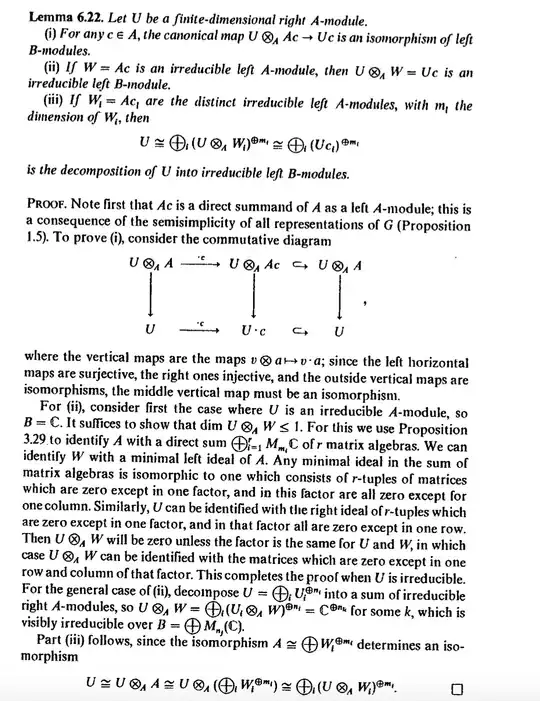

I am trying to understand the following proof from Fulton-Harris where they seem to be using this fact. enter image description here

  • I see your point. I was trying to understand a proof from the Fulton-Harris book. There they seem to be claiming that a minimal left ideal is of the form stated in my question. Have I misinterpreted what they are saying in the book? (I have added a picture of the proof in the question) – user569423 Sep 29 '20 at 20:07
    @user569423 "Any minimal ideal is isomorphic to* one which consists of..." That much is true. A semisimple artinian ring only has one isoclass of simple module. But you cannot show the left ideal is equal* to such a left ideal. – rschwieb Sep 29 '20 at 20:08
    oh yeah you are right. Need to be more careful next time when reading. Thank you. – user569423 Sep 29 '20 at 20:25
