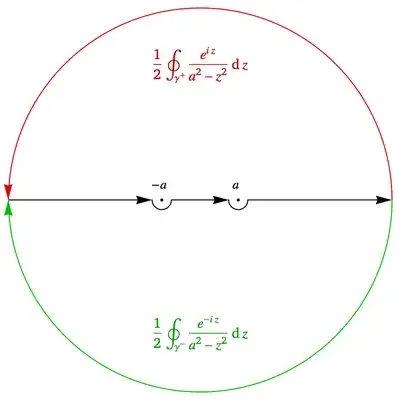

The Cauchy Principal Value $$ \mathrm{PV}\int_{-\infty}^\infty\frac{\cos(x)}{a^2-x^2}\,\mathrm{d}x $$ is the integral along a path that looks like this
where the gaps on each side of the points are the same, infinitesimal, size.
To compute the integral along the disjoint contours above, we connect those contours with counter-clockwise semi-circles around the two singularities, which adds $\pi i$ times the sum of the residues at those singularities:
Note that $$\require{cancel} \begin{align} \operatorname*{Res}_{z=a}\left(\frac{\cos(z)}{a^2-z^2}\right) &=\operatorname*{Res}_{z=a}\frac1{2a}\left(\frac{\cos(z)}{a-z}+\cancel{\frac{\cos(z)}{a+z}}\right)\\ &=-\frac{\cos(a)}{2a} \end{align} $$ and $$ \begin{align} \operatorname*{Res}_{z=-a}\left(\frac{\cos(z)}{a^2-z^2}\right) &=\operatorname*{Res}_{z=-a}\frac1{2a}\left(\cancel{\frac{\cos(z)}{a-z}}+\frac{\cos(z)}{a+z}\right)\\ &=\frac{\cos(a)}{2a} \end{align} $$ Thus, the sum of the residues at the singularities is $0$.
We now write $\cos(z)=\frac{e^{iz}+e^{-iz}}2$ and close the contour with two huge semi-circles:
$\gamma^-$ consists of the bumpy contour along the real axis and lower (green) semi-circle. $$ \frac12\oint_{\gamma^-}\frac{e^{-iz}}{a^2-z^2}\,\mathrm{d}z=0 $$ since there are no singularities inside $\gamma^-$.
$\gamma^+$ consists of the bumpy contour along the real axis and upper (red) semi-circle. $$ \begin{align} \frac12\oint_{\gamma^+}\frac{e^{iz}}{a^2-z^2}\,\mathrm{d}z &=\frac12\oint_{\gamma^+}\frac{e^{iz}}{2a}\left(\frac1{a-z}+\frac1{a+z}\right)\mathrm{d}z\\ &=\frac{2\pi i}{4a}\left(-e^{ia}+e^{-ia}\right)\\[6pt] &=\frac\pi{a}\sin(a) \end{align} $$ Since the integrals along the semi-circular contours vanish as radius of the circle goes to $\infty$, we get that the integral along the bumpy, real-axis contour is $$ \int_\text{bumpy}\frac{\cos(z)}{a^2-z^2}\,\mathrm{d}z=\frac\pi{a}\sin(a) $$
The integral along the bumpy, real-axis contour is the principal value integral plus $\pi i$ times the sum of the residues at the singularities, which was $0$. Therefore, we get that $$ \bbox[5px,border:2px solid #C0A000]{\mathrm{PV}\int_{-\infty}^\infty\frac{\cos(x)}{a^2-x^2}\,\mathrm{d}x=\frac\pi{a}\sin(a)} $$
