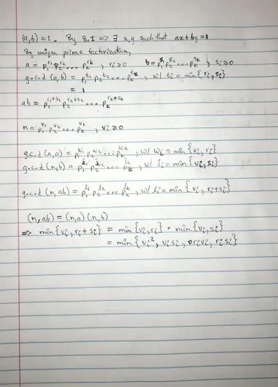

My solution.
This is what I have been able to come up with so far.
I know that using Bezout's identity the g.c.d can be written into the sum of the products of two numbers (with a and b included). I also know that every number has a unique prime factorization, and to find the g.c.d you take the minimum value of the exponent for each prime number.
Additionally, I recognized that for the g.c.d of a and b to be 1, that means their prime factorization must include exponents raised to the zero power.
However, I am lost as to how to put all of this together to complete the proof.
CORRECTION For the last two lines it is supposed to be: min(v_i, r_i + s_i) = min(v_i, r_i) + min(v_i, s_i) and disregard the last line.
Tikwen
  • 17
  • Thanks, I will try to make use of this next time but I don't think I really need it for this question. @Shaun – Tikwen Sep 25 '20 at 16:27
  • Why is it 'times' on the second-to-last line on your paper? Aren't you looking at exponents, which add? – Akiva Weinberger Sep 25 '20 at 16:58
  • That's true, I seemed to have overlooked that fact in my general confusion. @AkivaWeinberger – Tikwen Sep 25 '20 at 16:59
  • Also, if $p^{t_1}\dotsb {p_k}^{t_k}=1$, we have $t_i=0$, so $\min{r_i,s_i}=0$. That means, for any $i$, either $r_i=0$ or $s_i=0$. So each $i$ can be broken into two cases. – Akiva Weinberger Sep 25 '20 at 17:02
  • Yes, I was also thinking about that while trying to solve this problem. So, putting together the fact that the exponents are supposed to be added and that either r or s equals to zero for a particular i , this means that my last line would look like this: min(v,r) or min(v,s) for a particular i is equal to min(v,r) or min(v,s) for that same i ? – Tikwen Sep 25 '20 at 17:12

Let's consider only the primes where the exponents are greater than zero. Since a and b are coprime, your r's and your s's are disjoint and $min(v,r+s)$ is just either $min(v,r)$ or $min(v,s)$ You are mistaken in muliplying $min(v,r)$ and $min(v,s)$; they should be added, and you only get one or the other for a given prime, not both.
I don't think Bezout's inequality enters into it.
  • By looking at primes where the exponents are greater than zero, this means that r would be equal to zero for a given prime and s would be some number greater than zero (or vice versa). Is that what you are implying? And if so, then the g.c.d (n, ab) would either be min(v,r) or min(v,s) ? – Tikwen Sep 25 '20 at 17:05
  • The exponents of the gcd would be the minimum of the exponents in either n and a or n and b depending on whether the prime in question is a factor of a or a factor of b – Anna Naden Sep 28 '20 at 07:15
