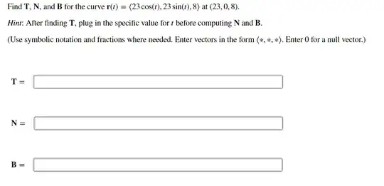

Not exactly sure what they want here?
Is T the derivative and N is the normal vector? What's B then? There is no prior reference to these letters in my textbook my teacher's notes/slides, or in previous questions. Any ideas are welcome.

$T,N$ and $B$ are the unit tangent, unit normal and binormal vectors respectively.
Provided that $r'(t)\neq 0 $ you have $$T(t)=\frac{r'(t)}{||r'(t)||}$$
$$N(t)=\frac{T'(t)}{||T'(t)||}$$ and $$B(t)=T(t) \times N(t).$$
Also see the Frenet–Serret formulas and here.
Alessio K
  • 10,679
$B$ is $T\times N$, the cross product. There has to be some reference somewhere. This is standard differential geometry. $T,N$ and $B$ constitute what's known as a moving frame. You can look up Frenet-Serret formulas.
These are the Frenet-Serret formulas for curves in $\mathbb R^3$. $B$ is the binormal vector. $T$ is tangent vector and $N$ the normal vector.
