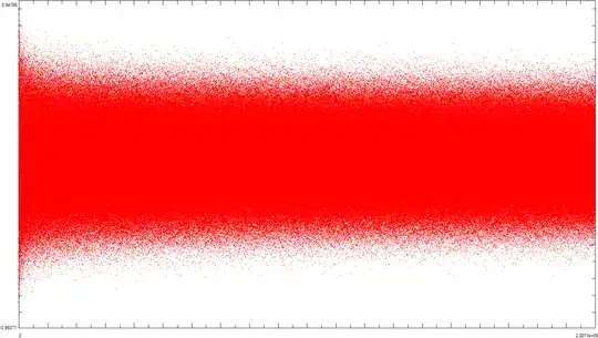

(+1) Interesting discussion and answers! Three years earlier I searched the best constant $C$ in following approximate value of the imaginary part of the $n$-th non-trivial zero (from your initial expression of course) : $$\;t_n\approx 2\pi\,\exp(W((n-7/8-C)/e)+1)=2\pi\dfrac{n-7/8-C}{W((n-7/8-C)/e)}$$ and conjectured that $C$ had to be exactly $\dfrac 12$ (computing different moving averages and so on). Further the actual error doesn't exceed $\pm 1$ for the first $2$ million zeros as illustrated :
errors for 2 million terms
Notice the vertical symmetry around $0$ and the slow decrease of the variance of the error with $n$ (a correction term depending of $n$ appears less interesting than in your question, if needed at all, since the mean error remains near $0$ for values as large as $10^{22}$ using Andrew Odlyzko's tables ).
Anyway I found this a neat illustration of the gentle statistical distribution of the zeros.
We seem further able to find the position of the $n$-th zero for $n$ as large as we want with an error of less than one (the error for the $10^4$ zeros following $10^{22}$ is less than $0.21$).
For $\,n=10^{22}+1\,$ for example the formula gives us
$t_n\approx 1370919909931995308226.770224\ $ while the actual zero is at : $t_n= 1370919909931995308226.680161\cdots$
