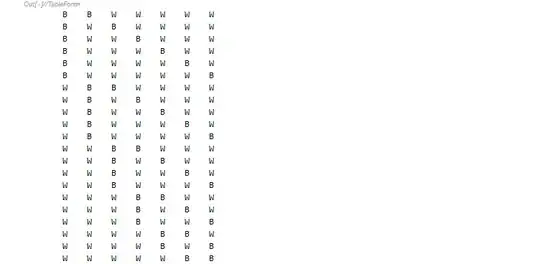

For your example to verify the correct answer consider listing all of the possible and equally likely arrangements of the 2 black and 5 white balls:
One can count that out of the 21 possible arrangements, 10 of those have the first two balls chosen being white.
That should convince you that adding the two probabilities is not appropriate.
