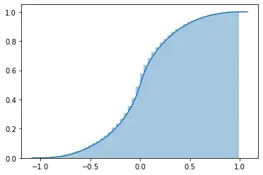

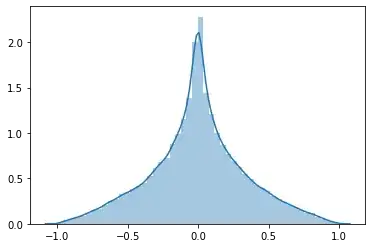

I plotted the simulated PDF and CDF. In that order, they are:
PDFCDF
So I'm aiming to find a CDF that looks like the second image.
