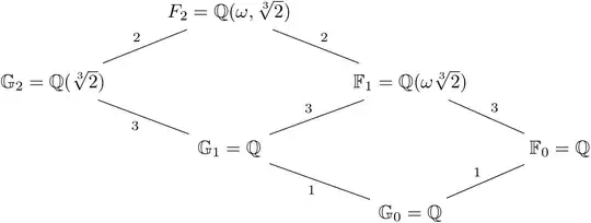

Here's an illustration of an example, with $\omega=\frac{-1+\sqrt{-3}}2\not\in\mathbb R$ and $\alpha=\sqrt[3]2\in\mathbb R$:
Diagram created in LaTeX using the tikz-cd package.
The diagonal lines denote extensions. Notice that $[\mathbb G_2:\mathbb G_1]=3\not\leq2=[\mathbb F_2:\mathbb F_1]$.
