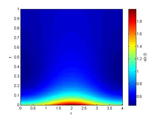

This is the easy way. The pde15s routine from the Chebfun package seems to solve this problem correctly. For a bump shaped initial condition with $L=4$, $B=10$, $u_0=1/2$, I get plots like
pde15s plot
, which has the diffusion kind of properties I would expect from this equation. My numerical experiments tell me that in order to see interesting behavior, you have to have the equation on a ring with periodic boundary conditions (like the authors of that paper), or you need non constant initial conditions. For the constant initial conditions and Neumann boundary conditions like you propose, the solution doesn't even depend on $x$, i.e. the lack of initial $x$ variations can't be "smoothed out" any further by this kind of diffusion equation, so the solution is just a constant in $x$ along the rod that changes in time.
