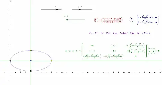

The equation of the family of ellipses that is tangent to both axis has the following equation: $$F(x,y,\alpha)\equiv\frac{\left[\left(x-\sqrt{a^{2}\cos\alpha^{2}+b^{2}\sin\alpha^{2}}\right)\cos\alpha+\left(y-\sqrt{b^{2}\cos\alpha^{2}+a^{2}\sin\alpha^{2}}\right)\sin\alpha\right]^2}{a^2}+ \frac{\left[\left(x-\sqrt{a^{2}\cos\alpha^{2}+b^{2}\sin\alpha^{2}}\right)\sin\alpha-\left(y-\sqrt{b^{2}\cos\alpha^{2}+a^{2}\sin\alpha^{2}}\right)\cos\alpha\right]^2}{b^2}-1=0; a<b $$ where $0<\alpha<\frac{\pi}{2}$ is the parameter, and a and b are minor and major axes respectively.
I tried to solve this system of equation to remove the parameter $\alpha$ but I couldn't (because the parameter $\alpha$ is everywhere). If i try to combine these equations it just results in a really complex equation with the parameter still in it.The equation that I get after simplifying are: $$F(x,y,\alpha)=n^{2}(x-m)^{2}+(-a^{2}+b^{2})(x-m)(y-n)\sin(\alpha)+m^{2}(y-n)^{2})$$ $$\partial_\alpha F(x,y,\alpha)\equiv \left[(x-m+n)^{2}-(y-n+m)^{2}\right]-2(x-m)(y-n)\tan(\alpha)-\left(\frac{mx-yn+n^{2}-m^{2}}{mn}\right)\frac{(-a^{2}+b^{2})\sin(\alpha)}{2}=0$$
where $m=\sqrt{a^{2}\cos\alpha^{2}+b^{2}\sin\alpha^{2}}$ and $n=\sqrt{b^{2}\cos\alpha^{2}+a^{2}\sin\alpha^{2}}$ I've tried a lot to remove the parameter $\alpha$ but so far I've failed to do so.So my questions are " Is there any way that I can eliminate the parameter $\alpha$ and get the equation of the envelope?" and if there isn't then "Is there any other way to solve the hallway problem that I just proposed?" I asked my teacher but he had no idea how to solve it, so could you please help?

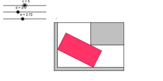

In order to avoid confusion ,I'm uploading a picture of a similar problem in which there is a rectangle of maximum area that passes through the left-turn hallway instead of an ellipse(so that you can get the idea of the type of hallway I'm talking about).I learned about this method from this link here. enter image description here

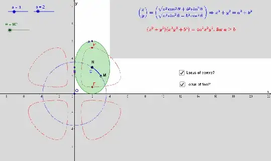

  • Centre of ellipse
$$(h,k)=(\sqrt{a^2\cos^2 \theta+b^2\sin^2 \theta},\sqrt{a^2\sin^2 \theta+b^2\cos^2 \theta}) \tag{2}$$
$$\partial_\theta (h,k)=(a^2-b^2)\sin \theta \cos \theta \left( -\frac{1}{h},\frac{1}{k} \right) \tag{3}$$

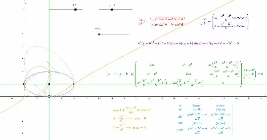

With careful calculation, $F_\theta=0$ is a rectangular hyperbola of Apollonian:
\begin{align} 0 &= 2SC(x - h)^2 - 2(C^2-S^2)(x - h) (y - k)-2SC(y - k)^2 \\[8pt] &\quad \; +2SC \left \{ (x-h) \left[ \frac{k^2}{h}+\frac{(a^2-b^2)SC}{k} \right]- (y-k) \left[ \frac{h^2}{k}+\frac{(a^2-b^2)SC}{h} \right] \right \} \\[5pt] S & \equiv \sin \theta \\[8pt] C & \equiv \cos \theta \end{align}
The intersection of $F=0$ and $F_\theta=0$ is the feet of the concurrent normals from a point $(\alpha,\beta)$ where $\alpha$ and $\beta$ are the $x$ and $y$ intercepts of the ellipse. In general, there're four intersections whilst the intercepts being the trivial solutions.

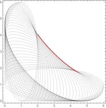

Giving that $F(x,y,\alpha,a,b)=0$ represents an ellipse, we have that if $F(x^*,y^*,\alpha,a,b) \gt 0$ means that $(x^*,y^*)$ is outside the ellipse so we need to determine for which points $(x^*,y^*)$ we have $F(x^*,y^*,\alpha,a,b) \ge 0$ for all $\alpha\in[\alpha_{min},\alpha_{max}]$. To obtain those solutions we proceed as follows:
1 - From $F(x_0,y,\alpha,a,b)=0$ we obtain $y = Y(x_0,\alpha,a,b)$. There are two solutions and we follow with one of them.
2 - Calculate $dY(x_0,\alpha,a,b) = \frac{dy}{d\alpha}$.
3 - Calculate a root $\alpha_0$ of $dY(x_0,\alpha,a,b)=0$.
4 - Now $y_0 = Y(x_0,\alpha_0,a,b)$.
5 - The procedure Headroom implements those steps.
Follows a MATHEMATICA script implementing this process.
F[x_, y_, alpha_, a_, b_] := ((x - Sqrt[a^2 Cos[alpha]^2 + b^2 Sin[alpha]^2]) Cos[alpha] + (y - Sqrt[b^2 Cos[alpha]^2 + a^2 Sin[alpha]^2]) Sin[alpha])^2/a^2 + ((x - Sqrt[a^2 Cos[alpha]^2 + b^2 Sin[alpha]^2]) Sin[alpha] - (y - Sqrt[b^2 Cos[alpha]^2 + a^2 Sin[alpha]^2]) Cos[alpha])^2/b^2 - 1
Y[x_, alpha_, a_, b_] := (Sqrt[2] a^2 Sqrt[a^2 + b^2 + (-a^2 + b^2) Cos[2 alpha]] + Sqrt[2] b^2 Sqrt[a^2 + b^2 + (-a^2 + b^2) Cos[2 alpha]] + Sqrt[2] (a^2 - b^2) Cos[2 alpha] Sqrt[a^2 + b^2 + (-a^2 + b^2) Cos[2 alpha]] + 4 a^2 b^2 Sqrt[(x (-x + Sqrt[2] Sqrt[a^2 + b^2 + (a^2 - b^2) Cos[2 alpha]]))/(a^2 b^2)] - (a^2 - b^2) (-2 x + Sqrt[2] Sqrt[a^2 + b^2 + (a^2 - b^2) Cos[2 alpha]]) Sin[2 alpha])/(4 (a^2 Cos[alpha]^2 + b^2 Sin[alpha]^2))
dY[x_, alpha_, a_, b_] := ((a^2 - b^2) Sin[ 2 alpha] (Sqrt[2] a^2 Sqrt[a^2 + b^2 + (-a^2 + b^2) Cos[2 alpha]] + Sqrt[2] b^2 Sqrt[a^2 + b^2 + (-a^2 + b^2) Cos[2 alpha]] + Sqrt[2] (a^2 - b^2) Cos[2 alpha] Sqrt[a^2 + b^2 + (-a^2 + b^2) Cos[2 alpha]] + 4 a^2 b^2 Sqrt[(x (-x + Sqrt[2] Sqrt[a^2 + b^2 + (a^2 - b^2) Cos[2 alpha]]))/(a^2 b^2)] - (a^2 - b^2) (-2 x + Sqrt[2] Sqrt[a^2 + b^2 + (a^2 - b^2) Cos[2 alpha]]) Sin[2 alpha]))/(4 (a^2 Cos[alpha]^2 + b^2 Sin[alpha]^2)^2) + (-2 (a^2 - b^2) Cos[2 alpha] (-2 x + Sqrt[2] Sqrt[a^2 + b^2 + (a^2 - b^2) Cos[2 alpha]]) + ( Sqrt[2] a^2 (a^2 - b^2) Sin[2 alpha])/Sqrt[a^2 + b^2 + (-a^2 + b^2) Cos[2 alpha]] - (Sqrt[2] b^2 (-a^2 + b^2) Sin[2 alpha])/Sqrt[a^2 + b^2 + (-a^2 + b^2) Cos[2 alpha]] - 2 Sqrt[2] (a^2 - b^2) Sqrt[a^2 + b^2 + (-a^2 + b^2) Cos[2 alpha]] Sin[2 alpha] - (2 Sqrt[2] (a^2 - b^2) x Sin[2 alpha])/(Sqrt[a^2 + b^2 + (a^2 - b^2) Cos[2 alpha]] Sqrt[(x (-x + Sqrt[2] Sqrt[a^2 + b^2 + (a^2 - b^2) Cos[2 alpha]]))/(a^2 b^2)]) + (Sqrt[2] (a^2 - b^2)^2 Sin[2 alpha]^2)/Sqrt[ a^2 + b^2 + (a^2 - b^2) Cos[2 alpha]] + ((a^2 - b^2)^2 Sin[4 alpha])/( Sqrt[2] Sqrt[a^2 + b^2 + (-a^2 + b^2) Cos[2 alpha]]))/(4 (a^2 Cos[alpha]^2 + b^2 Sin[alpha]^2))
Headroom[x0_, a0_, b0_] := Module[{}, solalpha = FindRoot[dY[x0, alpha, a0, b0], {alpha, Pi/4}]; Return[Y[x0, alpha, a0, b0] /. solalpha[[1]]]]
a = 1; b = 3;
gr1 = Show[Table[ContourPlot[F[x, y, alpha, a, b] == 0, {x, 0, 2b}, {y, 0, 2b}, ContourStyle -> {Thin, Black}], {alpha, 0, Pi/2, 0.05}]] gr2 = ParametricPlot[{x, Headroom[x, a, b]}, {x, 1.8, 4.4}, AspectRatio -> 1, AxesOrigin -> {0, 0}, PlotStyle -> Red]; Show[gr1, gr2]
Follows a plot showing the case $a = 1, b = 3$
NOTE
The plot range (calculation range) in this case $[1.8, 4.4]$, can be obtained from the black involute graph.
