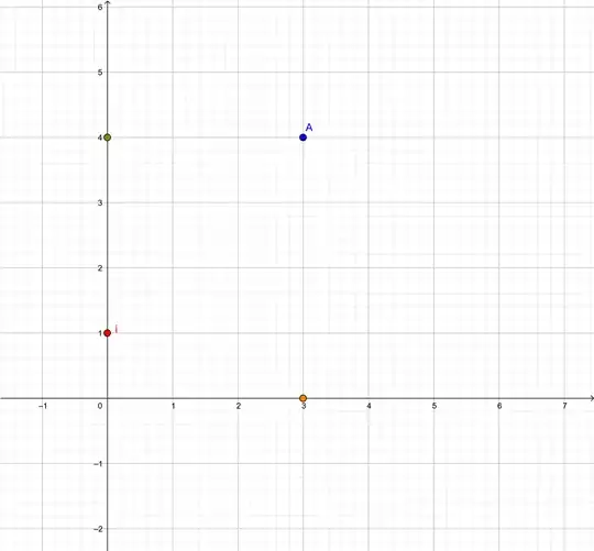

Complex numbers are not very abstract: in fact, everyone knows them, but under another name: points in a grid. The question reflects a misunderstanding of what a complex number is.
At the very beginning of the study of geometry, one learns to place points in a Cartesian frame, often an orthonormal frame.
The set of real numbers (or real line) is denoted $\mathbb{R}$; there is no distinction to be made between points $(x,y)$ of the euclidean plane $\mathbb{R}\times\mathbb{R}$ and complex numbers $x+iy$; if we note $\mathbb{C}$ the set of complex numbers instead of $\mathbb{R}\times\mathbb{R} $ or $\mathbb{R}^2$, it is just to remember that in addition to the addition of the vectors in $\mathbb{R}\times\mathbb{R} $, there is defined a multiplication which makes $\mathbb{C}$ a field.
For a nod to the image with the three oranges, here is an illustration of the complex number $\color{blue}A=\color{orange}3+\color{green}4i$ : enter image description here
