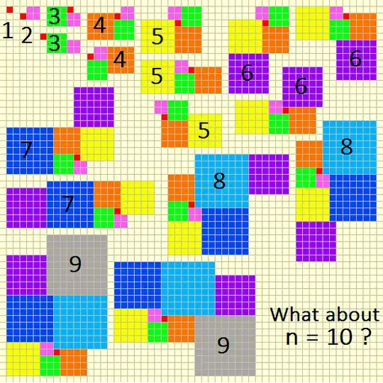

An oppositely bitten rectangle will be called $n$-squared (where $n$ is a positive integer) if it could be represented as the union of $n$ many non-overlapping squares with side lengths $1,2...,n$ respectively. Here is a picture of several $n$-squared, oppositely bitten rectangles for $1\le n\le 9$.
<span class=$n$-squared, oppositely bitten rectangles, $1\le n\le 9$" />
(Picture made with the help of Pattern designer for craft projects.)

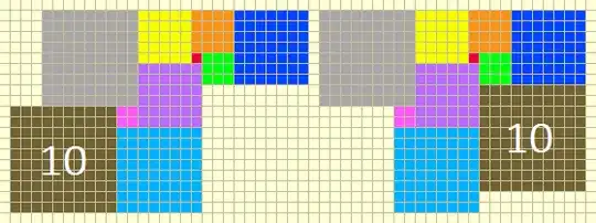

Edit. I found a $10$-squared, oppositely bitten rectangle, here is a picture. (As seen, these are two slightly different versions, depending on where you choose to put the square with side length $5$.)
<span class=$10$-squared, oppositely bitten rectangle" />

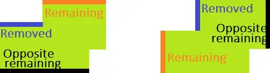

For an oppositely bitten rectangle let us introduce the following terminology - remaining length, removed length, and opposite remaining length, as illustrated by the following picture. (Of course, there are in general four choices of the remaining length and corresponding removed length, and opposite remaining length that go with it.)
remaining, removed, and opposite remaining length

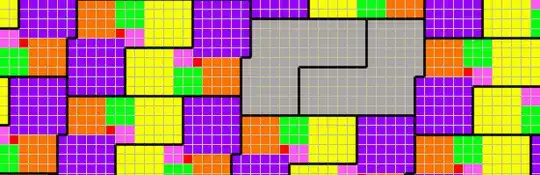

An evenly bitten rectangle is an oppositely bitten rectangle for which there is a choice of a remaining length and a corresponding removed length that are equal. Any evenly bitten rectangle $R$ could be put together with $^-R$ to form a symmetrically bitten rectangle, which could be used to tile the plane. Here is an illustration, starting with a $6$-squared, evenly bitten rectangle.
<span class=$6$-squared, evenly bitten rectangle" />

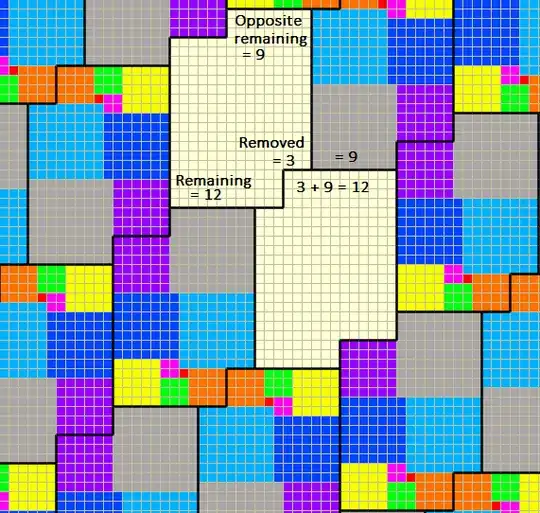

We introduce one more variation of an oppositely bitten rectangle, which we call a nicely bitten rectangle. This is the case (by definition) when a remaining length equals the sum of the corresponding removed length and opposite remaining length. In this case we put $R$ and $^-R$ together, and obtain a centrally symmetric shape which in general is not an oppositely bitten rectangle, but nevertheless could be used to tile the plane (in a regular manner, by translation). Here is an illustration, starting with a $9$-squared, nicely bitten rectangle.
<span class=$9$-squared, nicely bitten rectangle" />

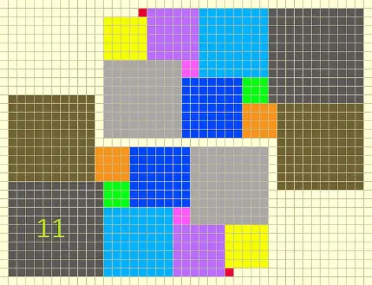

Here is an unsuccessful attempt at an $11$-squared, oppositely bitten rectangle. The result instead is what one might call an adjacently bitten rectangle. This $R$ (taken with its copy $^-R$ rotated $180^o$) does not seem to tile the plane.
<span class=$11$-squared, adjacently bitten rectangle" />
Here is another $10$-squared, oppositely bitten rectangle which is not nicely bitten (nor evenly bitten, nor trivially bitten). Moving the 10-square, one obtains an adjacently bitten rectangle.
Another <span class=$10$-squared, oppositely bitten rectangle" />
