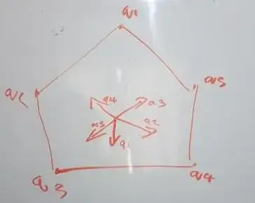

Edit: On some more thought, could I use a similar method for finding the 'Torricelli point' of more complicated shapes? seems like it should easily be doable by the same principles.
For example, finding the 'toricelli point' of the pentagon reduces to the problem of finding a way to arrange the 5 unit vectors such that their sum is zero as shown below. Further speaking, how would one generally find an arrangement such that adds to zero? enter image description here

  1. "could I use a similar method for finding the 'Torricelli point' of more complicated shapes?"
Well, the part where the 'Torricelli point' is the one where unit vectors from the point to the vertices sum up to zero is indeed the same, and for the same reason. The problem is that for 3 vectors the only way this can be true is that the all have angles 120 between any pair of the vectors -- so that the Torricelli point must have this "120 degree" property. For any higher number of vectors, there are infinitely many possible configurations of unit vectors that sum up to zero. So the condition "the vectors sum to zero" is much less restrictive. It must be combined in some non-trivial way with the condition that these vectors point from P to the vertices of our polygon. It is not immediately clear to me how one would do this.
  1. "For example, finding the 'toricelli point' of the pentagon reduces to the problem of finding a way to arrange the 5 unit vectors such that their sum is zero as shown below. Further speaking, how would one generally find an arrangement such that adds to zero?"
Precisely. For 5 vectors you can easily produce many such arrangements: summing 2 unit vectors one can get a vector in arbitrary direction of any size between 0 and 2. Now take any triangle with one side $\vec{v}$ of size 1 and two others of sizes between 0 and 2. Make these two "other" sides by summing some pairs of unit vectors, and finally add the last unit vector equal to $\vec{v}$. The overall sum of 5 vectors is then the sum of the 3 vectors making up the triangle, i.e. $\vec{0}$.
Now, for a random configuration of this type you will not find a point P such that the vector from it to your 5 vertices make this configuration. Hence it is not clear how to find "Torricelli points" of pentagons using this kind of method.
