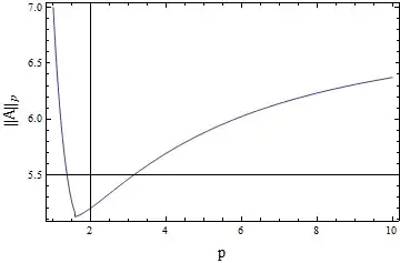

Finally, here is a plot of the $p$-norm of the OP's matrix with varying $p$:
plot of p-norm of {{2, 1, 4}, {3, 0, -1}, {1, 1, 2}}
