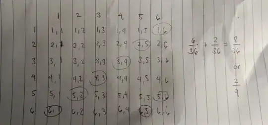

What's the probability of getting a total of $7$ or $11$ when a pair of fair dice is tossed?
I already looked it up on the internet and my answer matched the same answer on a site. However, though I am confident that my solution is right, I am curious if there's a method in which I could compute this faster since the photo below shows how time consuming that kind of approach would be. Thanks in advance.

    You should be able to solve problems like that without paper in a few seconds. First, you know there are 36 different possible throws: 2 die each with 6 faces, gives 36 possible throws. There are only 2 ways to get 11: 6-5 and 5-6, along with 6 ways to get 7: 1-6, 6-1, 5-2, 2-5, 3-4, 4-3. 8 total ways to 7 or 11: 8/36 = 2/9 = 0.22222 – stretch Aug 14 '20 at 02:26
    Please do Not Post an Image of the formulas. Use Latex or Format This table as code – miracle173 Aug 14 '20 at 02:35

To calculate the chance of rolling a $7$, roll the dice one at a time. Notice that it doesn't matter what the first roll is. Whatever it is, there's one possible roll of the second die that gives you a $7$. So the chance of rolling a $7$ has to be $\frac 16$.
To calculate the chance of rolling an $11$, roll the dice one at a time. If the first roll is $4$ or less, you have no chance. The first roll will be $5$ or more, keeping you in the ball game, with probability $\frac 13$. If you're still in the ball game, your chance of getting the second roll you need for an $11$ is again $\frac 16$, so the total chance that you will roll an $11$ is $\frac 13 \cdot \frac 16 = \frac{1}{18}$.
Adding these two independent probabilities, the chance of rolling either a $7$ or $11$ is $\frac 16+ \frac{1}{18}=\frac 29$.

For $7$, see that the first roll doesn't matter. Why? If we roll anything from $1$ to $6$, then the second roll can always get a sum of $7$. The second dice has probability $\frac{1}{6}$ that it matches with the first roll.
Then, for $11$, I like to think of it as the probability of rolling a $3$. It's much easier. Why? Try inverting all the numbers in your die table you had in the image. Instead of $1, 2, 3, 4, 5, 6$, go $6, 5, 4, 3, 2, 1$. You should see that $11$ and $3$ overlap. From here, just calculate that there are $2$ ways to roll a $3$: either $1, 2$ or $2, 1$. So it's $\frac{2}{36} = \frac{1}{18}$.
Key takeaways:
  • $7$ is always $\frac{1}{6}$ probability
  • When asked to find probability of a larger number (like $11$), find the smaller counterpart (in this case, $3$).

The number of positive integer solutions to $a_{1}+a_{2}=7$ is $\binom{7-1}{2-1}=6$. Therefore the probability of getting $7$ from two dice is $\frac{6}{36}=\frac{1}{6}$.
For $11$ or any number higher than $7$, we cannot proceed exactly like this, since $1+10=11$ is also a solution for example, and we know that each roll cannot produce higher number than $6$. So we modify the equation a little to be $7-a_{1}+7-a_{2}=11$ where each $a$ is less than 7. This is equivalent to finding the number of positive integers solution to $a_{1}+a_{2}=3$, which is $\binom{3-1}{2-1}=2$. Therefore, the probability of getting $11$ from two dice is $\frac{2}{36}=\frac{1}{18}$

There sure is a quicker way; you just have to quickly enumerate the possibilities for each by treating the roll of each die as independent events.
There are six possible ways to get 7 - one for each outcome of the first die - and two possible ways to get 11 - one each in the event that the first die is 5 or 6 - meaning you have eight total possibilities . There are $6^2=36$ possibilities for how the two dice could roll, so you have a $\frac{8}{36}=\frac{2}{9}$ chance of rolling either one.
