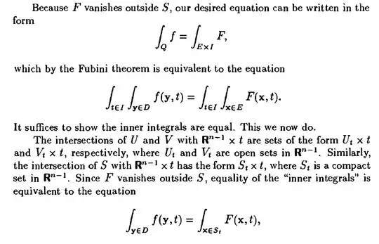

Now studing the proof of change of variables theorem in the text "Analysis on Manifols" by James Munkres it seems that here it is used implicitly the following statement.
Statement
If $S$ is a rectifiable subset of $\Bbb R^{n-1}$ then the projection on $S':=S\cap(\Bbb R^{n-1}\times\{t\})$ on $\Bbb R^{n-1}$ is rectifiable too in $\Bbb R^{n-1}$.
So first of all we observe that $S'$ is rectifiable since $\Bbb R^{n-1}\times\{t\}$ is closed and so $\partial S'\subseteq\Bbb R^{n-1}\times\{t\}$ so that if the last set has measure zero (see here) then $\partial S'$ has measure zero. Then the restriction $\phi$ to $\Bbb R^{n-1}\times\{t\}$ of the projection map $\pi_{\Bbb R^{n-1}}$ of $\Bbb R^{n-1}\times\{t\}$ is a homeomorphism so that $\phi[\partial S']=\partial\big(\phi[S']\big)$ thus to prove the statement we have to prove that $\phi[\partial S']$ has measure zero but unfortunately I don't be able to do this. Indeed to prove this last thing I imaged that if $S$ is a subset of $\Bbb R^n$ that has measure zero then $S':=\pi_{_{\Bbb R^m}}[S]$ has zero measure in $\Bbb R^m$ for any $m<n$ but unfortunately this seems uncorrect because for example $\Bbb R^{n-1}\times\{t\}$ has measure zero but $\pi_{\Bbb R^{n-1}}\big[\Bbb R^{n-1}\times\{t\}\big]=\Bbb R^{n-1}$ has not measure zero. To follow for sake of completeness I show the passage of the proof that I don't understand.
So if $S_t$ is rectifiable then by previous lemma $F$ is here integrable and by the additivity property of integrale the last equality holds. So how prove that $S_t$ is rectifiable? So could someone help me, please?
