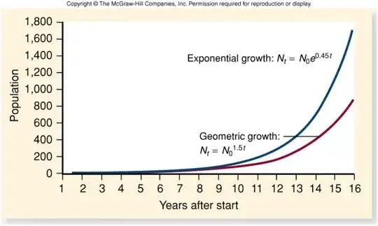

Update: I have found a diagram similar to the book in which I saw the concept. Geometric Vs exponential Source: https://cmapspublic3.ihmc.us/rid=1R0TPVNFG-113V4JS-1H9C/1R2CJ0126I1VCLY5MI1GHRIimage

Logarithmic growth and exponential growth is inverse of one another. Difference between exponential growth and geometric growth is that as wikipedia has stated "In the case of a discrete domain of definition with equal intervals, it is also called geometric growth or geometric decay since the function values form a geometric progression." in https://en.m.wikipedia.org/wiki/Exponential_growth . This means geometric growth is exponential growth but exponential takes real number as it's exponent and geometric just integer implying geometric growth is not continuous as exponential growth is.
  • Can I say that the 2 graphs are basically same, and one is just continuous and other is just discrete? If I can find that ecology book (certainly I have wrote its name and publisher some or some place) I will be further able to specify my question. –  Aug 03 '20 at 17:32
  • The book suggested 2 different graphs as I shown in the attachment. –  Aug 03 '20 at 17:33
    @AlwaysConfused The graph in attachment is different since they are different function. – Robert John Aug 03 '20 at 17:37
I'll extend a little the scope of your question, presenting some more growth rates. The rates of growth are given by the following formulae: $$ \begin{matrix} \text{Logarithmic:} & \log(x)\\ \text{Linear:} & x\\ \text{Polynomial} & x^a\\ \text{Factorial:} & x! \\ \text{Exponential:} & x^x \\ \end{matrix} $$ You can notice that the distinction between exponential and geometric in the texts you found is due to the parameter $a$. One property we can stablish is $\log(n) \ll n \ll a^n \ll n! \ll n^n$. That means that when $x$ goes to infinite and $a \ll b$, $b$ grows faster than $a$ and eventually surpasses it. To check logarithmic, linear vs. polynomial/exponential growth just do the usual line plot. The later will grow much faster than the former. One way of making the distinction between polynomial and exponential is by ploting them in log-scale, the difference of growth becomes more apparent.
