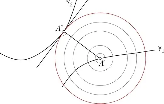

A geometric argument, assuming that a shortest segment exists:
Take any point $A$ on the first curve $\gamma_1$. In order to find the point nearest to $A$ on the second curve $\gamma_2$ draw a small circle centered at $A$ and blow it up until it meets, in fact touches, the second curve $\gamma_2$ at some point $A'$. From all points on $\gamma_2$ this point $A'$ is nearest to $A$. The segment $A A'$ is a radius of the circle, hence orthogonal to the common tangent of the circle and $\gamma_2$ at $A'$.
Of course this works also in the other direction. It follows that for any segment from $\gamma_1$ to $\gamma_2$ that is not orthogonal on both curves the above circle construction finds a shorter one.
