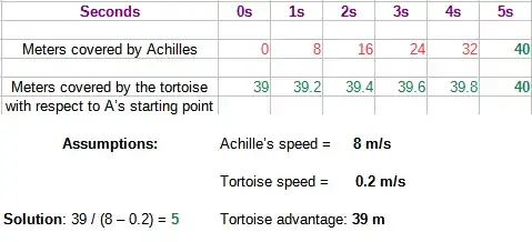

    I think the apparent paradox is you have task1 that must be completed and when completed leads to task 2 and you have an infinite number of these tasks which must be completed one after another and there is no last task. Intuitively such a situation seems like it can not be capable of ending. Or if it does end it does so be doing one last task (which can not exist)....Secondarily, if every task takes a finite amount of time intuitively doing an infinite number of them should take infinite time. (the second is resolved by infinite sums. the first by....well, thinking about it. – fleablood Aug 05 '20 at 15:56
Short answer: When two procedures used to solve a problem lead to different results (a paradox), the solution to the paradox is to show why one of the procedures is wrong. It is NOT showing why the wrong procedure must, would, or should lead to the same result. A complete explanation, and the solution, are given below.
What Does Solving a Paradox Mean?
As mentioned at the beginning of my article (at: https://bit.ly/2IM76rF ), a paradox proposes the existence of two different results as a solutions for the same problem. These results are inconsistent with each other, depending on which procedure is used. Only one can be correct. As Brown and Moorcroft suggest, we are not looking for a mathematical demonstration that Achilles reaches the tortoise. Assuming they are both running in the same direction, we know he will. We can calculate the exact time, given the distance between the two and the two speeds, using a simple formula:
t = distance/(difference in velocity)
Instead, explaining or invalidating a paradox is to show a fault in the paradox formulation, or the proposed solving procedure, so that we can exclude this procedure and demonstrate that there is only one result for the original problem. The solution of a paradox is the answer to the question: “How does the paradox formulation misrepresent reality or logic?” That is, we need to show why the proposed method is conceptually wrong. Solving a paradox, invalidates the formulation of a problem proposed by the author of the paradox and leaves us with only valid procedures for solving the original problem.
Why were the previous proposed solutions for the paradox not satisfactory?
Most, if not all, the proposed solutions to Zeno’s paradox assume that Zeno’s proposed procedure is correct. The procedure seems to be logical when it is first introduced to us, but we will see that the procedure proposed by Zeno is conceptually incorrect. The authors then used a procedure similar to Zeno’s faulty procedure to reach the expected correct result for the original problem.
For example, the simple way mentioned earlier to solve the problem (not the paradox) can be examined using a spreadsheet. Given the assumptions in the diagram below, the time for Achilles to reach the tortoise is 5 seconds:
39 m / 7.8 m/s = 5 s
A simple mathematical solution for the problem
If we calculate a sum of an infinite series, as several mathematicians have suggested, we obtain the same result: Achilles will reach the tortoise. By applying any legitimate mathematical solution to the problem, we state, in another way that: We can prove that Achilles reaches the tortoise.
What is the problem then?
We know that Zeno is wrong: The fact that his procedure never ends, does not imply that Achilles will never reach the tortoise. We can prove this mathematically in many ways. Intuitively we all agree with the mathematicians. However, when mentally following the proposed repetitive procedure, the paradox puzzles our mind.
What are the facts?
  1. Asserting that Zeno’s procedure never ends is correct, as we can prove it by writing a recursive computer program that follows Zeno’s steps. The program will never end, and never will provide us with the expected result, because the condition for the end of the recursion process (Achilles reaches the tortoise) would never occur.
  2. Asserting that Achilles never reaches the tortoise is wrong, as we can prove that he does, by using several mathematical procedures.
Thus, we must conclude that Zeno’s procedure to solve the problem, is not correct.
The question is then: Why is Zeno’s procedure wrong? The key word in the previous assertions is “never”. Never implies time and the problem must be considered in the context of space and time.
The Explanation of Zeno's Paradox:
Zeno's proposition invites the solver to do a series of steps each time changing system of reference: STEP 1: The starting system of reference: The point where Achilles starts the race and the tortoise is well ahead, STEP 2: After a while, we are then asked to use a new system of reference: The point where Achilles reached and where the tortoise initially started, with the the tortoise now a bit further ahead, STEP 3: Then again we are asked to use, recursively, a new system of reference with the new starting point for Achilles and with the tortoise still further ahead, with every step we are asked to freeze the process and then continue by re-creating and examining the original problem using a different system of reference.
Today we know more about the relative motion of two bodies. Solving a problem that involves space and time, requires a defined system of reference, which cannot be changed without the proper conversions.
NOTE: The concept of a system or reference, or frame of reference, in elementary physics is founded on Einstein's Special Theory of Relativity, First Postulate: All velocities are measured relative to some frame of reference.
After Zeno's proposed first step, or first change of system of reference, the problem, as presented in the second step, is exactly the same as the original, the only change being a difference in "scale". No progress was achieved in solving the problem. Changing system of reference essentially restarts the problem-solving procedure. This realization implies that the problem is never going to reach a conclusion as the step by step procedure is reiterated. If the system of reference is changed at every step, our working spacetime shrinks with every step, the solution becomes elusive and the tortoise becomes apparently unreachable. Zeno proposes a procedure that never ends, for solving a problem that has a trivial solution.
Our Solution (Why Zeno's Formulation Is Incorrect)
Our solution of Zeno's paradox can be summarized by the following statement:
"Zeno proposes observing the race only up to a certain point, using a system of reference, and then he asks us to stop and restart observing the race using a different system of reference. This implies that the problem is now equivalent to the original and necessarily implies that the proposed procedure for solving the problem will never end."
That is, we cannot change system of reference in the middle of a problem involving velocity, space and time, whether the frame of reference is openly stated, or implied.
As an analogy, you cannot solve a problem involving measurements by using English Imperial measures at the start of calculations and then switch to metric measures (without proper conversions) in the middle of calculations.
Zeno's trick works, and puzzles our mind, because we are used to assume one frame of reference when solving this type of problems.
An example
The following is not a “solution” of the paradox, but an example showing the difference it makes, when we solve the problem without changing the system of reference. In this example, the problem is formulated as closely as possible to Zeno’s formulation.
Zeno would agree that Achilles makes longer steps than the tortoise. Let’s assume that one Achilles-step is about 20 tortoise-steps long, and let’s also assume that both Achilles and the tortoise make the same number of steps in the same amount of time. For example, two steps per second (the exact amount doesn’t really matter). If the tortoise starts the race 20 Achilles-steps ahead of him, then after 20 steps Achilles reaches where the tortoise was (See diagram below: Tortoise starting point).
No change of system of reference
In the meantime, the tortoise has made 20 of her steps, and she is now one full Achilles-step ahead of him. We have not changed our system of reference. We referred to both starting points. These did not move relatively to each other. We could choose any fixed ground point. To please Zeno, let’s continue by referring to the tortoise starting point, where Achilles currently is. When both runners make one more step, step 21, the tortoise will have moved by one of her steps and she will still be ahead of Achilles by that one tortoise-step. Achilles is now one Achilles-step ahead of the tortoise starting point. Now, let’s continue, without changing the system of reference. This is the key point. We do not redefine the problem and use the current positions of the runners as new starting points, as Zeno proposes, but we refer to the information about the race we have already accumulated in our knowledge base. Achilles then completes his 22nd step, and he is two Achilles-steps ahead of the tortoise starting point. The tortoise will have completed her 22nd tortoise-step from her starting point. Hence the tortoise is now behind Achilles by 18 tortoise-steps. Thus, if we do not change the system of reference, the paradox does not appear.
ggori
  • 39
    When linking to your own site or content (or content that you are affiliated with), you must disclose your affiliation in the answer in order for it not to be considered spam. Having the same text in your username as the URL or mentioning it in your profile is not considered sufficient disclosure under Stack Exchange policy. – cigien Aug 26 '21 at 02:16
    Full disclosure: The article linked is on Medium. It was written by me (Giuseppe Gori) and it includes the same explanation, with an additional historical context. – ggori Aug 26 '21 at 02:57
  • @gg70 This is a good explanation. But, first, the assertion " Solving a problem that involves space and time, requires a defined system of reference, which cannot be changed without the proper conversions." is not very convincing. Second, you use a fixed step(time interval) to consider every result in the middle, which seems to say "I close my eyes and calculate the distances using elementary algebra in my mind in the interval, then when I open my eyes, Achilles and the tortoise are right at my calculated positions. My elementary algebra says Achilles can be ahead of the tortoise... – William Aug 28 '21 at 15:31
  • @gg70 so the possibility Achilles can not catch up the tortoise does not exist." Dare you open your eyes in the unlimited instances in the interval to draw the conclusion? – William Aug 28 '21 at 15:36
  • Reply to William: You say: first, the assertion " Solving a problem that involves space and time, requires a defined system of reference, which cannot be changed without the proper conversions." is not very convincing. REPLY: See Einstein, Special Theory of Relativity, Frames of Reference. The notion is now part of elementary physics. – ggori Aug 29 '21 at 23:32
  • William, with regards to the second part of your comment, you are right. Asserting that Achilles never reaches the tortoise is wrong, as we can prove that he does, by using several mathematical procedures. I added this assertion to my explanation. Thanks. – ggori Aug 30 '21 at 16:13
