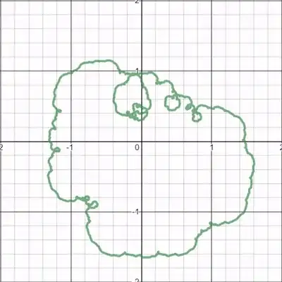

During my regular recreational late night Desmos foolery, I came across this fractal parametric equation:
$$x(t)=\sum_{n=0}^\infty \frac{\cos(2^nt+cn)}{2^n}$$ $$y(t)=\sum_{n=0}^\infty \frac{\sin(2^nt+cn)}{2^n}$$
And decided to animate $c\rightarrow2\pi$ on a loop.
fractal string
I was fascinated by the series of loops around it's boundary that seemed to curl into existence then proceed to unwind back into thin air. If the gif doesn't do it justice, I highly recommend checking out the link to the graph.
I'm sure this phenomenon is actually just an example of a much simpler process, but I can't seem to wrap my head around these spiraling loops. What are your thoughts?

  • Have you tried playing with your parameters? E.g. changing some of the $2$'s to $3$'s or change some of the $2^n$ to $n^2$. I'd say there is nothing special about your function. It's just a "circle" which deforms in a cyclic way. – WhatsUp Jul 23 '20 at 13:09
  • this is the image of the unit circle under the function $f(z)=\sum_ {n=0}^\infty 2^{-n} z^{2^n+cn}$, which is a lacunary series – Albert Jul 23 '20 at 13:17
  • @WhatsUp I have, indeed I'm sure there's nothing special, as per my "I'm sure this phenomenon is actually just an example of a much simpler process". I'm curious to as what the cyclic deformation is actually a result of however. – Graviton Jul 23 '20 at 13:27
    The problem is that you should translate this phenomenon into mathematical language, rather than a description such as "curl into existence" or "unwind back into thin air". – WhatsUp Jul 23 '20 at 13:50
    @WhatsUp I agree. Believe me, if I could, I would. Otherwise, who says poetry and math don't overlap ;) – Graviton Jul 25 '20 at 06:17
