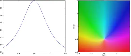

Let's say there is a real-valued "signal" that you can only measure at discrete points $f(x)$. You have a theory that this signal is the result of an analytic function $f(z)$ on the complex plane but, again, you can only measure this function on the real number line.
For example, the signal might look like the picture on the left, while the actual function on the complex plane is on the right (a simple pole at $1\pm1/2i$):

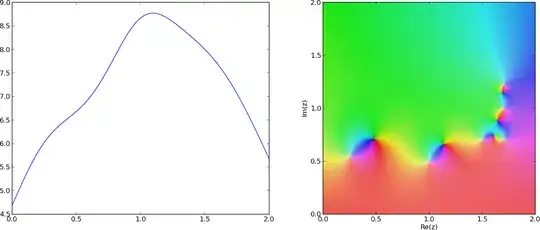

The function could be more complicated, but let's posit that the function only contains complex conjugate zeros, e.g.

The zeros of $f(z)$ are important because they impart asymptotics onto the measurable $f(x)$, roughly the further away the zero is from the real number line, the "less important" it is to the function.
Question: Given only $f(x)$ and the assumption that it is analytic on the complex plane with only a finite set of simple complex conjugate poles, what can we say about the zeros on the complex plane?
