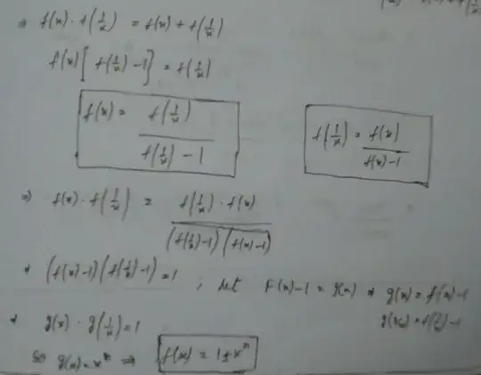

Solve the functional equation $f(x)+f(1/x)=f(x)\cdot f(1/x), x\in\mathbb R-\{0\}$.
Assuming $f(x)$ to be a polynomial, \begin{align*} (f(x)-1)\left(f\left(\frac1x\right)-1\right)&=1\\ (a_0^\prime+a_1x+\cdots a_nx^n)\left(a_0^\prime+\frac{a_1}x+\cdots \frac{a_n}{x^n}\right)&=1\\ \end{align*} is only possible when there is only one term in the brackets, i.e. $f(x)-1=\pm x^n$.
PS: I think this might help to generalize $f(x)$.
-1
Therefore,$$f(x)=1+x^n$$.
Hope this helps.

  • The conclusion $g(x)\cdot g\left(\dfrac{1}{x}\right)=1$ implies $g(x)=x^n$ is false. Read the comments under the question. – Batominovski Jul 17 '20 at 16:49
  • can you please explain why is $g(x)\cdot g\left(\dfrac{1}{x}\right)=1$ implies $g(x)=x^n$ i false(if i am not wrong in asking this) @Batominovski – Anonymous Jul 17 '20 at 17:04
  • There are counterexamples. Try $g(x):=\dfrac{\text{arccot}(x)}{\text{arctan}(x)}$. – Batominovski Jul 17 '20 at 17:06
  • oh, ok I understand, but I had only one of the possibilities of $g(x)$, i.e $g(x)=x^n$ could.The could be much better if they had asked the possible functions satisfying $g(x)$ – Anonymous Jul 17 '20 at 17:42
