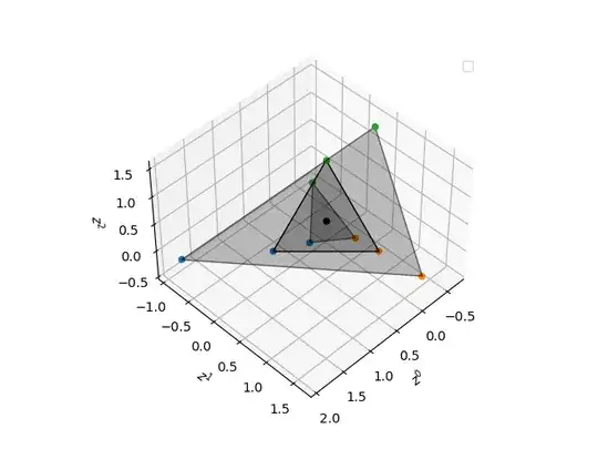

Let $\mathrm{conv}(M)$ denote the convex hull of the rows of matrix $M$. Geometrically, $\mathrm{conv}(P)$ is enclosed by the standard simplex (whose vertices are the standard basis vectors), and its inverse $P^{-1}$ is an enclosure of the standard simplex.
For example, if $$ P = \left[ \begin{array}{3} \color{blue}{0.60} & \color{blue}{0.30} & \color{blue}{0.10} \\ \color{orange}{0.15} & \color{orange}{0.70} & \color{orange}{0.15} \\ \color{green}{0.25} & \color{green}{0.00} & \color{green}{0.75} \end{array} \right], $$ then the geometry is as in the illustration below.
geometry
