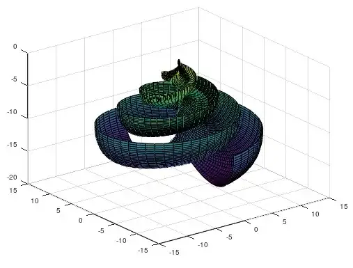

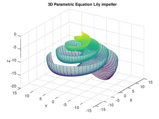

I can create a 3D Parametric Equation of a spiral but I'm having trouble getting the angle of "decent" to also change over time.
$$x=u\sin(u)\cos(v)$$ $$y=u\cos(u)\cos(v)$$ $$z=-u\sin(v)$$
The Octave code I have so far seems close, I'm just not sure how to "tweak" it. The image it creates is:
Octave image
clc
close all
clear all
u=linspace(0,4pi,100); v=linspace(0,pi,100); [u,v]=meshgrid(u,v); x=u.sin(u).cos(v); y=u.cos(u).cos(v); z=-u.sin(v); figure(1) mesh(x,y,z); view([-57,32]) h=gca; get(h,'FontSize') set(h,'FontSize',14) xlabel('X','fontSize',14); ylabel('Y','fontSize',14); zlabel('Z','fontsize',14); title('3D Parametric Equation Lily impeller','fontsize',14) fh = figure(1); set(fh, 'color', 'white');

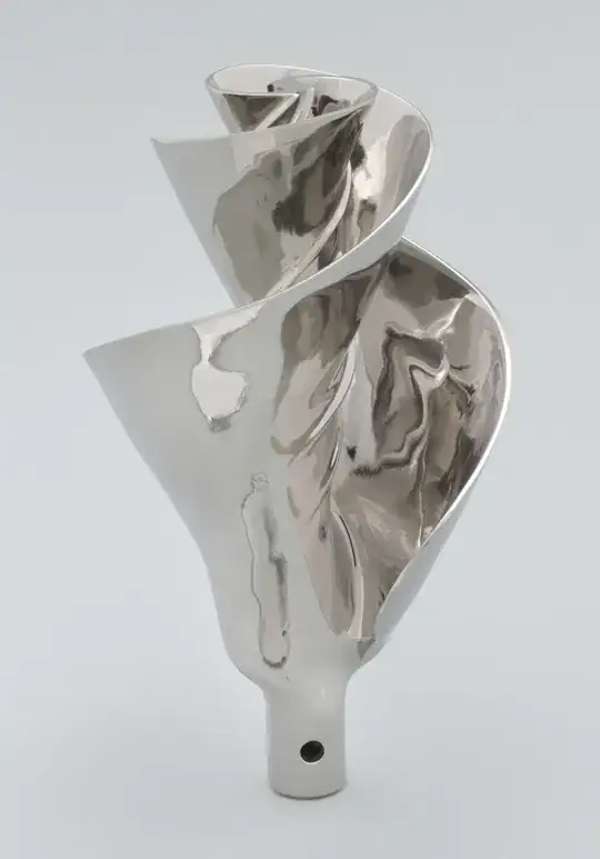

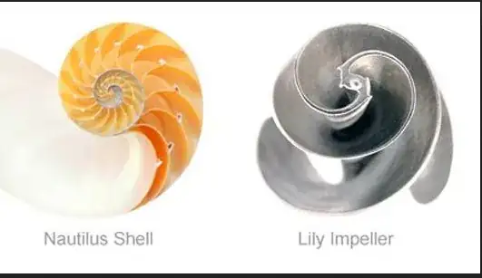

The image I'm trying to recreate is the Lily Impeller and how it's created/growth pattern takes shape over time.
lily impeller
Here's a video of what I'm trying to model/animate the growth pattern of. https://youtu.be/by0JhirtO-0?t=224
I was thinking that the descending curves in the $-Z$ direction may need to be at a $60^\circ$ angle or so but I couldn't come up with a way of how to do this.

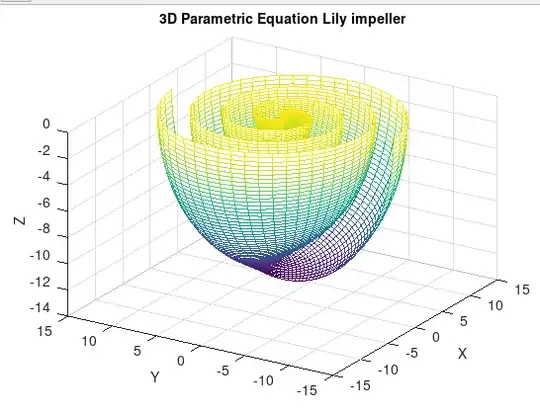

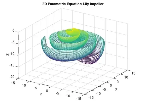

As the curve moves radially out from $(0,0)$ reduce $z$ at a $60^{\circ}$ angle.
z=-u.*sin(v) .-  sin(60/180 * pi)*(sqrt((x).^2 + (y).^2));
This subtracts a $60^{\circ}$ angle cone from the $z$ value.
surf(x,y,z)
You can adjust the angle and scale to match the image / your taste.
Depending on how you define the angle:
z=-u.*sin(v) .-  cos(60/180 * pi)*(sqrt((x).^2 + (y).^2));
clc
close all
clear all
u=linspace(0,4pi,100); v=linspace(0,pi,100); [u,v]=meshgrid(u,v); x=u.sin(u).cos(v); y=u.cos(u).cos(v); z=-u.sin(v) .- sin(60/180 * pi)*(sqrt((x).^2 + (y).^2)); figure(1) mesh(x,y,z); view([-57,32]) h=gca; get(h,'FontSize') set(h,'FontSize',14) xlabel('X','fontSize',14); ylabel('Y','fontSize',14); zlabel('Z','fontsize',14); title('3D Parametric Equation Lily impeller','fontsize',14) fh = figure(1); set(fh, 'color', 'white');
