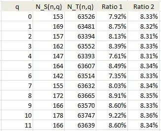

I did some experiments and here are the results, using $n=12, b=\frac{1}{2}$ and looking at all elements of $S$ and $T=S+S$ up to $10^6$:
Equidistribution in $S$ (modulo $n=12$ in this case) means that the "Ratio_1" tend to be identical and equal to $\frac{1}{n}$as you look at more and more elements of $S$, while equidistribution in $T$ means that the "Ratio_2" tend to be identical also converging to $\frac{1}{n}$.

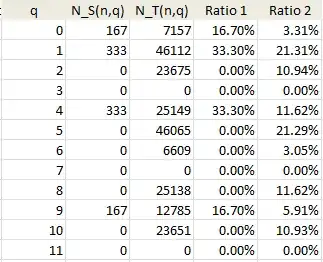

I also did the same test on the set $S$ of perfect squares, which is notoriously not equidistributed. The results are below.

  • For perfect squares, $a=1, b=\frac{1}{2}, c=0$. Even though $T$, the set of sums of two perfect squares is not equidistributed, the set $T+T$ is the set of all non-negative integers, and is thus equidistributed (that set of course has $a=0, b=1, c=0$).
  • The last table suggests that the equations $x^2 + y^2 = 12z+ 3$, $x^2 + y^2 = 12z+ 7$, $x^2 + y^2 = 12z+ 11$ do not have integer solutions, while $x^2 + y^2 = 12z$, $x^2 + y^2 = 12z+6$ and $x^2 + y^2 = 12z+9$ might have only finitely many solutions.
