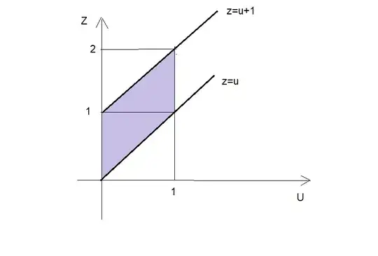

a simple way to see the solution is to observe that
$$v=z-u$$
thus
$$0<z-u<1$$
this means that the joint density $f_{ZU}(z,u)$ is Uniformly distribuited over this parallelogram
Thus to get the marginal $f_Z$ it is enough to integrate in $du$
