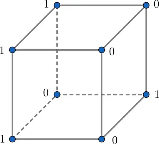

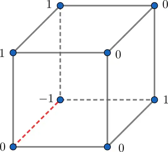

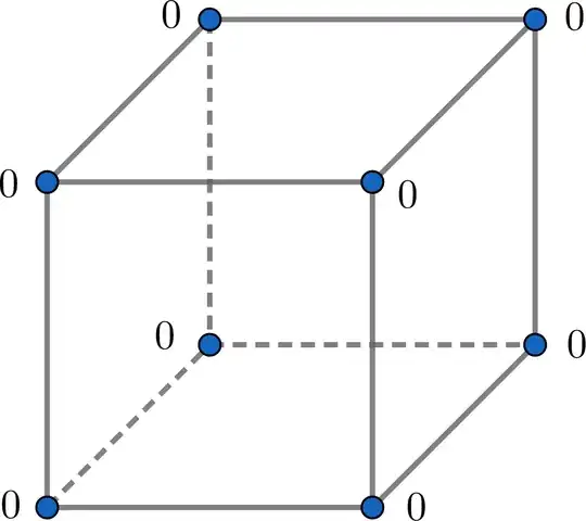

I heard of this in early 2000's: given a cube with number as each of it's vertices. Permitted operation is selecting an edge and adding same number to the both vertices at the ends of the edge. Is a state, where all numbers at the vertices are equal, achivable from given state (which may be arbitrary, but known) using only the permitted operation?
$\to$ $\overset{?}\to$
