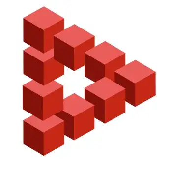

I can't resist posting an answer based on the Mathematics Stack Exchange logo.
Let's add some more cubes to the logo to make it clear that it's a subset of the Penrose triangle (or would be, if it was a real 3D object)
Now note that the cubes are overlapping, so some must be in front of others. But in fact, each cube is partially obscured by at least one other cube, in such a way that it appears to be some distance behind it. You can go around the hexagon in the original logo, in clockwise order, and see that each cube appears to be located further from the 'camera' than the next one in the cycle - which means that each cube is in front of itself. There's no consistent "z ordering" that you can give to the different parts of the figure, and that's one way to see that it's impossible.
In reply to some of the comments, just to be explicit, the point here isn't just that the cubes all overlap each other. If that was the case it would be incorrect, since it's possible to have mutually overlapping arragements of cubes, as in this image provided by Misha Lavrov.
However, if we're assuming that the Stack Exchange logo is a subset of the Penrose triangle then we know the cubes aren't arranged like that. Instead, each cube is positioned so that some of its sides are coplanar with those of the next cube, and each cube is separated from the next by some distance in the z direction, where z is perpendicular to the plane of the image. Therefore the cubes' centres of mass can't be given consistent z coordinates.
As an extra bonus point, even if we don't assume that, and instead assume that each cube is as close to the next as it can be (in the z direction) without the surfaces intersecting, the Math.SE logo still can't be made into a consistent 3D shape, as the following animation shows. Note that it doesn't quite form the Math.SE logo, since one cube ends up in front of all the rest. Of the six neighbouring pairs of cubes, three of them can have equal z coordinates, but for the remaining three pairs, one cube unavoidably has to have a greater z coordinate than the next.

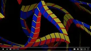

As another additional bonus point, although it's not possible to embed the Penrose triangle into normal, flat, Euclidean 3D space, it is possible to embed it into curved three dimensional space. The video below, by @ZenoRogue on Twitter, shows Penrose triangles embedded into something called "nil geometry". I don't pretend to understand the details, but it's a kind of curved space such that Penrose triangles really are possible.
video link: https://www.youtube.com/watch?v=YmFDd49WsrY
screenshot:

    Thanks, reading this answer made it intuitively "obvious" again to me. –  Jul 03 '20 at 12:51
    But ... you can have three cubes, where $A$ is in front of $B$ is in front of $C$ is in front of A, in the sense that $A$ partially obscures cube $B$ when you're looking at it.. With the cubes in the same orientation as your picture, put cube A with its bottom front corner in the center of the top face cube B, and put cube C so that its top left corner is in the middle of the right face of cube A. – Peter Shor Jul 03 '20 at 16:21
  • 23
    I feel like this is missing something since it's possible to have a set of 3d objects where each one is in front of and behind another. For example, when folding the sides of a cardboard box to close it: https://assets-global.website-files.com/5e136d26c5e98c478100e1c7/5e7504bffdfde87684302b74_no-tape-moving-box.jpeg. – mowwwalker Jul 03 '20 at 16:51
    @mowwwalker sure, but if you look at how the cubes are drawn, they appear not just to partially occlude each other, but to be actually located some distance behind each other in space. As in, if the figures actually represented real cubes in the way they appear to, their centres of mass would be at substantially different distances from the 'camera'. – N. Virgo Jul 04 '20 at 01:57
    Another interpretation of this image would be, if you label sides of the cube as X, Y, Z corresponding to the axes: you move 3 steps on the X axis, 3 on the Y axis, and 3 on the Z axis, which doesn't leave you back where you started. At least that's why this image looks suspicious to me. (Of course, this is then just a really good illustration of the answer by John Bentin) – Milo Brandt Jul 04 '20 at 02:34
  • @PeterShor after your comment I had to check, and it turns out that it's not possible to make the math.SE logo as a real 3D object using that trick. (Too bad - I'd have made a 3D printed one otherwise.) Here's an animation to show what I mean: https://gifyu.com/image/QTQd – N. Virgo Jul 04 '20 at 13:07
  • 9
    Here is a "possible triangle" with three cubes: https://i.sstatic.net/cSCg0.png Yet I feel like the same argument as in this answer (each cube is partially obscured by another) could be made for it, so this answer proves too much... – Misha Lavrov Jul 04 '20 at 15:44
  • There is probably a way to make this rigorous, but it's not satisfactory to me as stated. The comments have already pointed out why the argument falls short. – Caleb Stanford Jul 05 '20 at 02:11
  • @MishaLavrov did you view the animation in my previous comment? I made it specifically to address that issue, which was raised previously by Peter Shor. – N. Virgo Jul 05 '20 at 05:37
  • Okay, but just because one way to do it doesn't work, doesn't mean that there is no way that works. – Misha Lavrov Jul 05 '20 at 05:39
  • @MishaLavrov in my animation, the cubes are as close to each other (in the z direction) as they can be without intersecting each other. So in this particular case, the fact that that way doesn't work does imply that no other way will work. – N. Virgo Jul 05 '20 at 05:40
