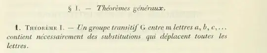

You might want to look at the following paper (1872) by Jordan:
C. Jordan, Recherches sur les substitutions, J. Liouville 17 (1872), 351–367. PDF link
In this paper, he proves that if a finite group $G$ acts transitively on a set $X$ of size $\geq 2$, then there exists an element $g \in G$ that does not fix any point in $X$.
jordan
The theorem you mention is a corollary of Théorème I. If $H$ is a proper subgroup, then $G$ acts transitively on the left cosets of $H$ by multiplication. Now $[G:H] \geq 2$ since $H$ is a proper subgroup, so there exists a $g \in G$ such that $gaH \neq aH$ for all $a \in G$. Hence $a^{-1}ga \not\in H$ and $g \not\in aHa^{-1}$ for all $a \in G$. In other words, $g$ is an element of $G$ that is not contained in $\bigcup_{a \in G} aHa^{-1}$.
In fact, we can use the theorem to prove Théorème I. If $G$ acts transitively on $X$, then the point stabilizers of $X$ are conjugate. Thus if every point fixes some point of $X$, then $G = \bigcup_{g \in G} aHa^{-1}$ for any $H = \operatorname{Stab}(x)$. If $|X| \geq 2$, then $H$ is a proper subgroup since $G$ is transitive.
I don't know a lot of French, but I don't think I see him actually mentioning in the paper that "a finite group cannot be the union of conjugates of a proper subgroup" (someone might want to check this). But I guess it is still safe to attribute that to Jordan, since it is an easy corollary of Théorème I, and the two results are equivalent anyway.
    Could you translate the enunciation of the theorem? – Pedro Apr 27 '13 at 20:19
  • @PeterTamaroff: Something like "A transitive group $G$ on $m$ letters $a, b, c, \ldots$ contains necessarily a permutation that moves every letter" – Mikko Korhonen Apr 27 '13 at 20:20
