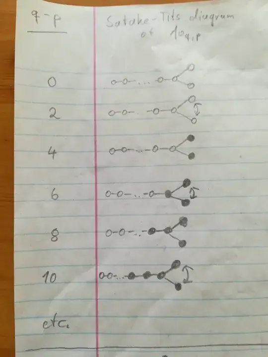

Turns out the Satake diagram has an arrow between the two "horns" of the Dynkin diagram, (which will make the restrictions of the two half-spin representations to the real Lie algebra conjugate to each other), iff $q-p (=2n-2p) \equiv 2$ mod $4$. Indeed, we have the following table:
(One way to see this: For $q \ge p+4$ the Lie algebra $\mathfrak{so}_{p,q}$ has anisotropic kernel $\mathfrak{so}_{0, 2n-2p}$ i.e. this compact subalgebra, and that one is dealt with in the classical compact case as in your question. In the remaining cases $q=p$ we have the split form without arrow, and $q=p+2$ gives the quasi-split form with an arrow. -- The visualisations in Onishchik/Vinberg as well as by Tits in the Boulder Proceedings (p.56/57) are unfortunate insofar as they do not draw arrows on black vertices, hence seem to not go into this case distinction for what they call $\mathfrak{so}_{p,2l-p}$; but they have the two remaining cases right. See my thesis pp. 86/87 for a more elaborate discussion.)
This matches that in the Wikipedia article for $q-p \equiv 2, 6$ mod $8$ we find "truly complex" representations, i.e. not equivalent to their own conjugate.
In particular, the two half-spin representations are conjugates of each other (hence not equivalent to their conjugates) for $\mathfrak{so}_{1,3}$ but not for $\mathfrak{so}_{0,4}$. And this is not because anything about their defining weights $\mu_{1}, \mu_2$ would change, but because when you complexify $\mathfrak{so}_{1,3}$ and look at how complex conjugation acts on roots, it switches two basis roots (which by extending the action to the weight lattice switches $\mu_2 \leftrightarrow \mu_{1}$), whereas if you complexify $\mathfrak{so}_{0,4}$ and look at how complex conjugation acts on roots, it sends each root to its own negative, which by extending the action to the weight lattice sends $\mu_2 \mapsto -\mu_2$ which, as you have noticed, gives a representation equivalent to $\mu_2$, and $\mu_{1} \mapsto -\mu_{1}$ whose highest weight irrep is up to equivalence the one of $\mu_1$ again.
